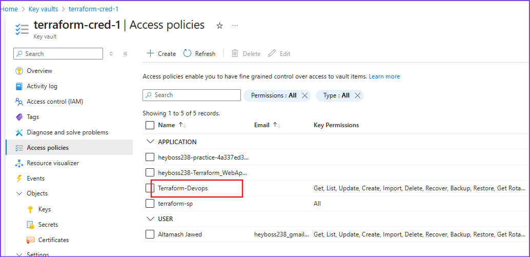

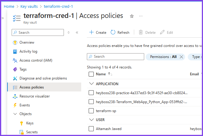

Every time I assign an access policy to a service principal in the Key Vault, it shows as successfully assigned.
However, when I refresh the page or navigate away and return to the access policy tab, the service principal is no longer visible. I’ve tried different browsers and even created new Key Vaults and service principals, but the issue persists.
