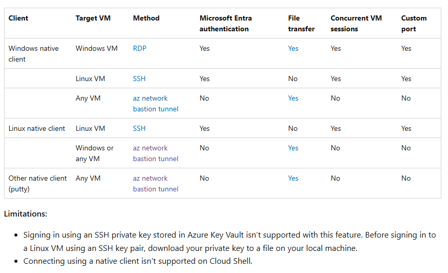

    As discussed, you’re experiencing an issue connecting to Azure Bastion using Microsoft Entra ID authentication through a browser session. However, the connection works as expected when using your local credentials.
    Please note that Azure Bastion login with Microsoft Entra ID is not a supported scenario, which is why the sign-in cannot be completed successfully.
    If you’re using a Mac to connect to Azure Bastion, the recommended approach is to use Azure Bastion’s tunnel mode (az network bastion tunnel). However, Microsoft Entra authentication is not supported in this mode. You’ll need to use traditional authentication methods such as SSH keys or username/password credentials.
    For your reference, the screenshot below shows that Microsoft Entra authentication is supported only for Windows and Linux native clients using RDP and SSH methods, and not available for other native clients.
    You can find more details here: Azure Bastion — Connect using the native client

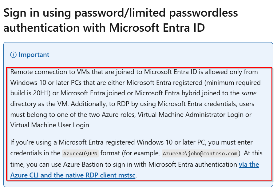

    Regarding your second issue with RDP login on Mac using Entra ID credentials, please note that RDP login with Entra ID is supported only on Windows 10 and later devices. It is not supported on Mac systems, which explains why the login attempt fails.
    Sign in using password/limited passwordless authentication with Microsoft Entra ID
