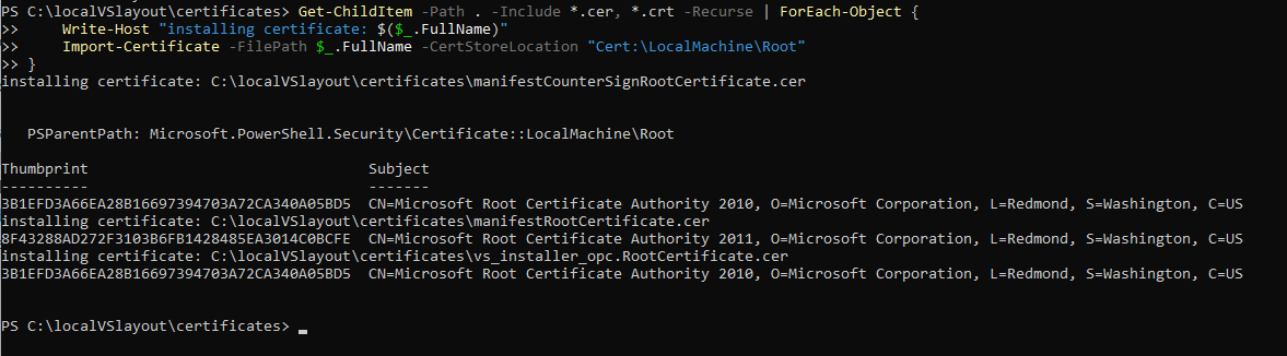

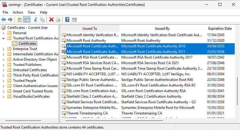

Thank you for the quick responses. I have done again what you mentioned regarding the certificates. Once again, I tried to install, and I got the same result. Here are the three logs that I have:
