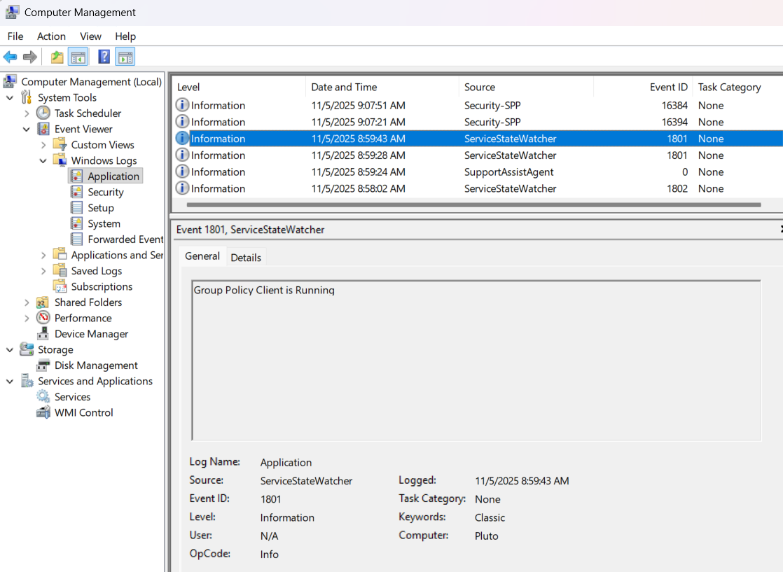

    You have to register the source.
    $log = "Application"
    $Source = "ServiceStateWatcher"
    # Check if our source is registered
    if ([System.Diagnostics.EventLog]::SourceExists($Source) -eq $false) {
        "Registering source $Source"
        New-EventLog -LogName $log -Source $Source
    "{0} - {1} starting." -f (get-date), $Source
    Write-EventLog -LogName $log -Source $Source -EventId 1800 -EntryType Information -Message "Script is starting." -Category 0
    $Prior = Get-Service | Select-Object -Property DisplayName, Status
    while ($true) {
        Start-Sleep -Seconds 5
        $Current = Get-Service | Select-Object -Property DisplayName, Status
        Compare-Object $Prior $Current -Property DisplayName,Status | foreach {
            if ($_.SideIndicator -eq "=>") {
                "{0} - {1} - {2}" -f (get-date), $_.Status, $_.DisplayName
                if ($_.Status -eq "Running") {
                    $id = 1801
                } elseif ($_.Status -eq "Stopped") {
                    $id = 1802
                } else {
                    $id = 1803
                Write-EventLog -LogName $log -Source $Source -EventId $id -EntryType Information -Message $("{0} is {1}" -f $_.DisplayName, $_.Status) -Category 0
        $Prior = $Current

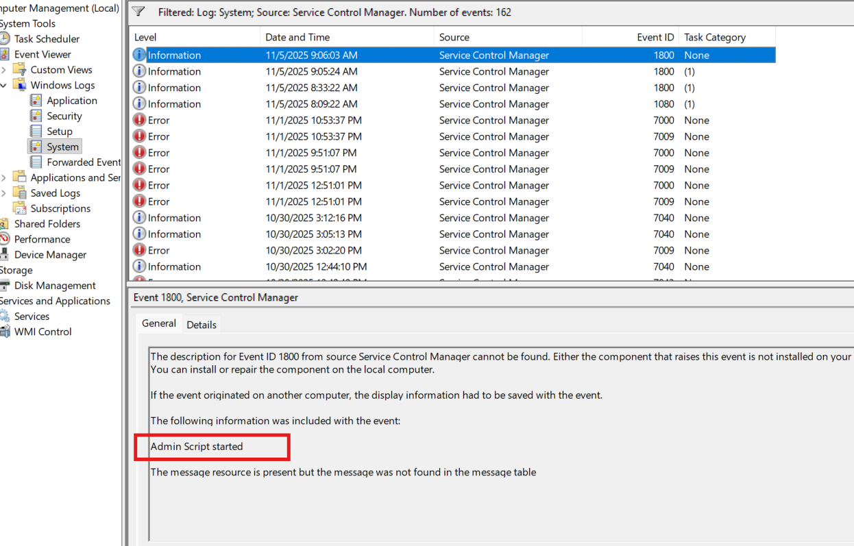

    You can write your own Service Control Manager events into the System eventlog...
    Write-EventLog -LogName System -Source "Service Control Manager" -EntryType Information -EventId 1800 -Category 0 -Message "Admin Script started"
    But they look like this.
