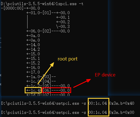

I am encountering device reset requirements while developing a KWDF driver for a PCIe endpoint device.
  1. The current endpoint device under development does not support Function-Level Reset (FLR), so the only option is to achieve hot reset by modifying the Secondary Bus Reset bit in the bridge controller register of its upstream PCIe root port's configuration space.
  2. Testing with the setpci tool has confirmed that modifying the Secondary Bus Reset bit at offset 0x3E of the upstream root port's register successfully resets the downstream endpoint device.

Test Example:
