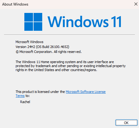

    As you're using Windows 11 24H2, please run the 25H2 enablement package to upgrade to 25H2.

    Please run winver.exe and post a screenshot.

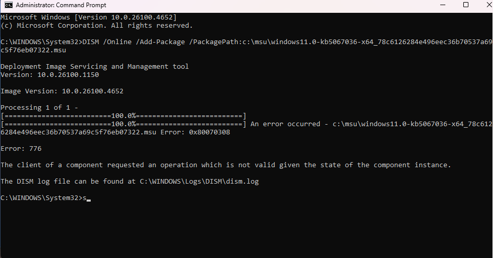

    Please download the following MSU files.
    windows11.0-kb5043080-x64_953449672073f8fb99badb4cc6d5d7849b9c83e8.msu
    windows11.0-kb5067036-x64_78c6126284e496eec36b70537a69c5f76eb07322.msu
    Move them to a folder on the C drive's root, for example C:\MSU
    Open Command Prompt (admin) and run this command:
    DISM /Online /Add-Package /PackagePath:c:\msu\windows11.0-kb5067036-x64_78c6126284e496eec36b70537a69c5f76eb07322.msu
    Restart Windows when prompted.
