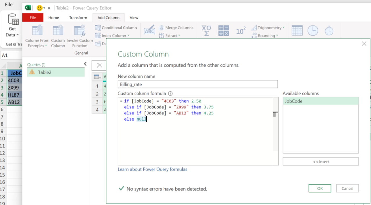

    • You select the table, then you go to “Data” => choose “From Table/Range” to open Power Query.
    • In the Power Query Editor, you choose “Add Column” => “Custom Column”, you can rename the new column to billing_rate, and you enter the following formula:
    = if [JobCode] = "4C03" then 2.50
    else if [JobCode] = "ZX99" then 3.75
    else if [JobCode] = "AB12" then 4.25
    else null
     For explaining:
    • [JobCode] refers to the column name in your table.
    • “null” means if the value does not match any of the conditions, it will remain blank (you can change this to 0 or any default value).
    After applying this, the result looked like this:
    Once again, thank you again for raising this issue; it’s helped broaden my understanding. I hope you understand that I want to help as much as I can within the scope of this forum.
    Look forward to hearing from you!
