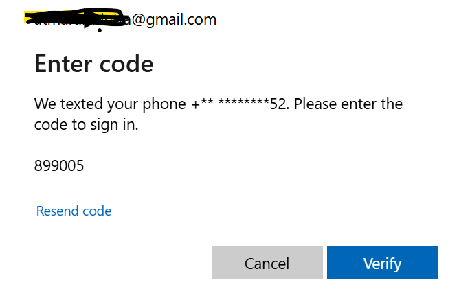

Hi All
I am trying to sign in to an app using entra external ID authentication. We have MFA where it send code(OTP) in sms over phone. I guess the expiry for that code is 10 minutes. So after 10 minutes when adding the code in the interface (shown below) and click next it does not show any error code/validation message. Although from network I can see the error.

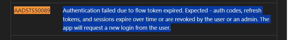

Network error:
"Success": false,
"ResultValue": null,
"Message": "AADSTS50089: Authentication failed due to flow token expired.",
"AuthMethodId": "OneWaySMS",
"ErrCode": 50089,
"Retry": false,
"FlowToken": "AQA.....",
"Ctx": "rQQI...",
"SessionId": ---PII removed---,
"CorrelationId": ---PII removed---,
"Timestamp": "2025-11-17T04:03:11Z",
"Entropy": 0,
"ReselectUIOption": 0,
"ContinuationToken": null,
"MobileAppAuthDetails": null

    Thank you for posting your question in the Microsoft Q&A forum. From what you’ve described and based on what I’ve researched, this is a known UX limitation in how Microsoft Entra handles expired OTP flow tokens during MFA. The backend correctly detects the issue and returns the error code AADSTS50089 (flow token expired) when the OTP exceeds the 10-minute validity window.
    However, the MFA interface does not surface any error message or validation feedback to the user, resulting in a silent failure even though the network trace shows the error. This limitation can be inconvenient because users have no indication that the code has expired. They simply see the process fail without explanation. It can lead to confusion, repeated attempts, and unnecessary troubleshooting.

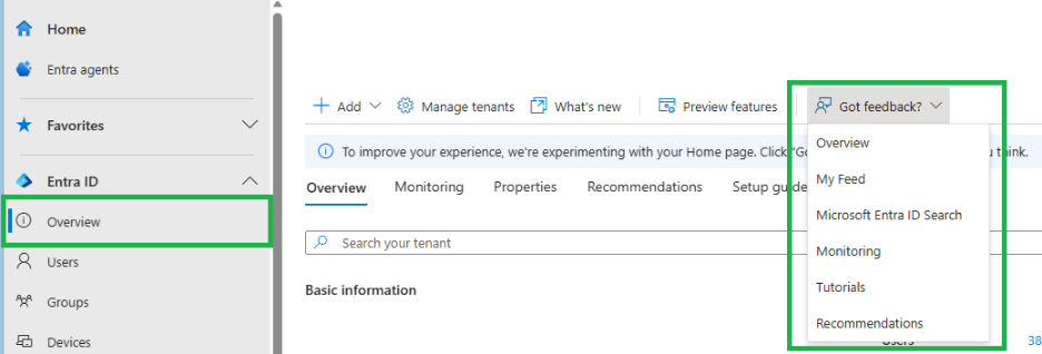

    If you are using the built-in Entra MFA form, you can raise this as feedback directly via Microsoft Entra so the product team can review and consider improving the user experience. For example, you might suggest adding a countdown timer for OTP validity or a clear error message when the code has expired.
