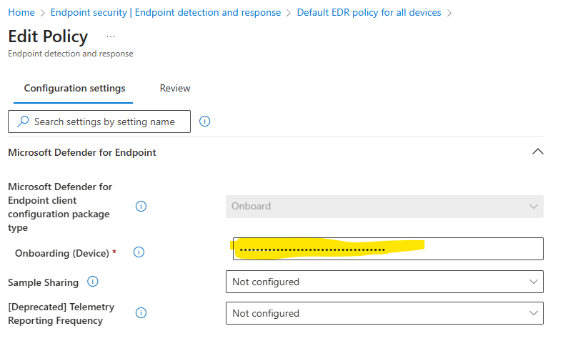

We are rolling out Defender via Intune for this customer. I’ve successfully enabled Hybrid Join, and MDM enrolment is working as expected. 50+ Windows 11 Devices are appearing in Intune; however, there are still 0 devices showing in the Microsoft Defender portal. When you click into any device within the default EDR policy, the Onboarding (Device) status shows Failed with error code 65000.
The default EDR policy is normally created automatically after clicking Get started and follow the prompts, but the “Welcome to Microsoft Defender for Business – Get started” page never appeared for this tenant. In situations like this, I normally have to enable the connector then create the EDR policy manually. During policy creation, the “Auto from connector” option did not appear from the drop down—only Onboard and Offboard were available. I tried toggling the Microsoft Intune Connector off and on multiple times; at one point, after turning it off, I received the message “A Microsoft Intune license was not found.”

  1. Michael Heagerty 5 Reputation points
    2025-11-24T05:31:29.2266667+00:00
    I had the same issue, but for M365 Business Premium specifically.
    To resolve, delete any custom EDR policies in Intune, then select 'Deploy preconfigured policy' from the 'EDR Onboarding Status' tab as shown:
    Microsoft article link for reference:
    https://learn.microsoft.com/en-us/intune/intune-service/protect/endpoint-security-edr-policy#use-a-preconfigured-edr-policy
    This must be a new change by Microsoft, as using the 'Auto from Connector' option for EDR policies would always work for in the past, but now this option has been removed.
