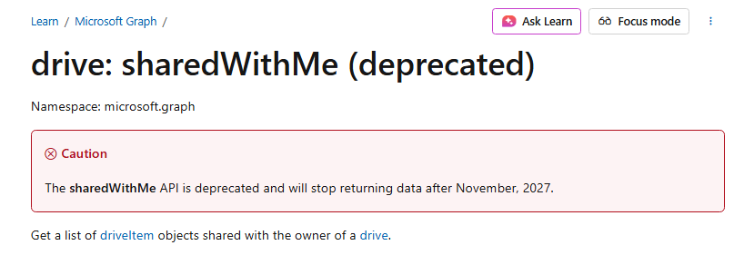

The Graph API GET /me/drive/sharedWithMe is marked as deprecated. What is the recommended replacement?
The Learn AI agent suggested that "The recommended replacement for this API is to use the driveItems returned from the sharedWithMe method." Does this mean that the API itself will not be removed, but only the response model will change?
  1. Jayden-P 26,280 Reputation points Microsoft External Staff Moderator
    2025-11-18T12:51:36.38+00:00
    Hi @Meg Gotshall
    Thank you for posting your question in the Microsoft Q&A forum.
    From this official document, it stated that sharedWithMe API is deprecated and will stop returning data after November 2027.
    It will be removed and no longer return any data from the calls.
    At this moment, Microsoft has not announced any alternative for this deprecated API.
    You can read here for more details: drive: sharedWithMe (deprecated) - Microsoft Graph v1.0 | Microsoft Learn
    I hope this information helps.
