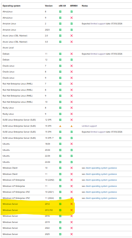

If I recall correctly, Azure Run Command was functioning on our Windows Server 2012 Azure Arc–enabled machines a couple of months ago. Is Run Command no longer supported for Windows Server 2012 Azure-Arc enabled server?

    The error from your logs indicate Failed to decode, decrypt, and deserialize the protected settings string. Error: Cannot decrypt protected settings with certificate due to: Invalid provider type specified (exit code -22) when using Run Command and Custom Script Extension on an Arc-enabled Windows Server 2012 machine.
    This is due to below following reasons:
    1. OS support boundary: Azure Arc’s Connected Machine agent (CMA) supports Windows Server 2012 R2 and later. Windows Server 2012 (non‑R2) isn’t in the supported list. When Arc features (including Run Command and extensions) try to decrypt protected settings, they rely on OS crypto providers. On legacy stacks (WS 2012 non‑R2) decryption can throw “Invalid provider type specified” because the private key/provider used by the agent’s transport certificate isn’t compatible with the OS crypto APIs.
    Reference: https://learn.microsoft.com/en-us/azure/azure-arc/servers/prerequisites
    1. Run Command requirements & current limitations: Run Command for Arc requires CMA v1.33+ and is supported via PowerShell/CLI/REST (Portal not yet). It doesn’t support authenticating script blobs using Managed Identity at this time, protected parameters are locally decrypted by the agent using its transport certificate. If certificate/provider handling fails, decryption of protected settings fails exactly as in your error.
    Reference: https://learn.microsoft.com/en-us/azure/azure-arc/servers/run-command
    1. Certificate/provider mismatch on Windows: On Windows, extension protected settings are decrypted using a transport certificate. Known failure modes include missing/expired transport cert, wrong key provider type, or incorrect permissions under C:\ProgramData\Microsoft\Crypto\RSA\MachineKeys.
    As a resolution If this machine is truly Windows Server 2012 (non‑R2), migrate/upgrade to 2012 R2 (or newer) before using Arc Run Command / CSE at scale.
