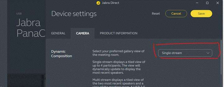

  1. Henry Eaton 5 Reputation points
    2026-06-24T10:42:39.4866667+00:00
    Hello friends.
    This issue has been plaguing us, and whilst we were able to use the work around of setting “Allow multiple apps to use the camera at the same time” via the Windows Settings app, we found this wasnt a permanent solution due to the affected PCs being set up as shared devices; user profiles are not permanent and therefore this setting would need to be toggled every time a user logged in.
    But thanks to showing this thread to our vendor account manager, who escalated to jabra, we have made progress!
    Jabra support have advised the following:
    Install/open Jabra Direct on the affected room PC.
    1. Select the Jabra PanaCast 50.
    2. Go to Device settings > Camera.
    3. Change Dynamic Composition from Off to Single-stream.
    4. Save the setting.
    5. Fully close and restart Microsoft Teams
    We deployed this to our meeting room devices via intune, and controlled the setting via Jabra Xpress, and are now experiencing Teams consistently working with the Jabra Panacast 50.
    I hope this helps gang!
