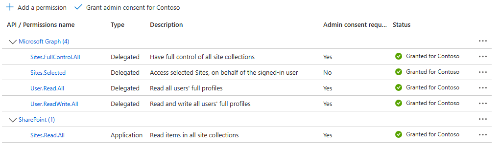

Here's the permission's I set on the client I used to log in with Connect-PnPOnline

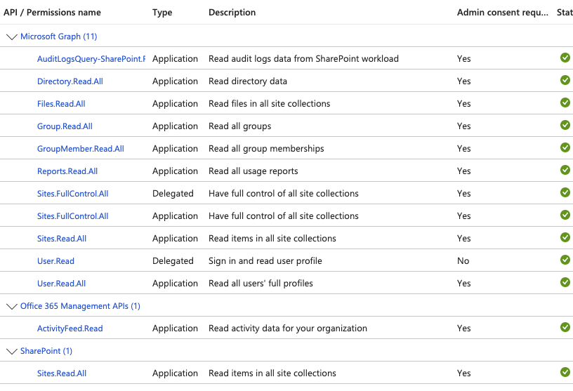

2. Permissions configured on my Azure AD application
These were the exact permissions assigned on the Azure AD application I used for testing:User's image
I recommend double-checking that your app’s permissions match.

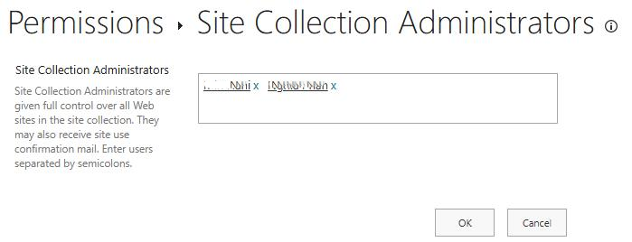

3. Connect-PnPOnline must target the my.sharepoint.com endpoint
One detail that can cause this exact issue is connecting PnP to the wrong endpoint.
For OneDrive personal sites, PnP must connect to:
https://<tenant>-my.sharepoint.com
If you connect to:
https://<tenant>-admin.sharepoint.com
the operation may fail because it is pointing to the admin site collection, not the personal OneDrive site.
If you are currently connected to the admin endpoint, please disconnect first and reconnect to the correct OneDrive URL.
Here is the exact connection command I used:User's image
