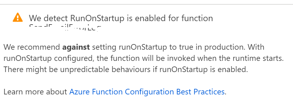

I have a function app deployed using package deployment. I have not set any code to have the RunOnStartUp enabled, but when I diagnose my app to check for any issues, I get the error. I have checked the host file and runOnStartup is disabled.

    @Joel Prescilla I was able to reproduce the issue and it is logging a warning if the “runOnStartup” setting is present, regardless of its actual value. I have engaged my product team and they are looking into it and will be fixing the issue.
    I will update my answer once the issue will be fixed.
