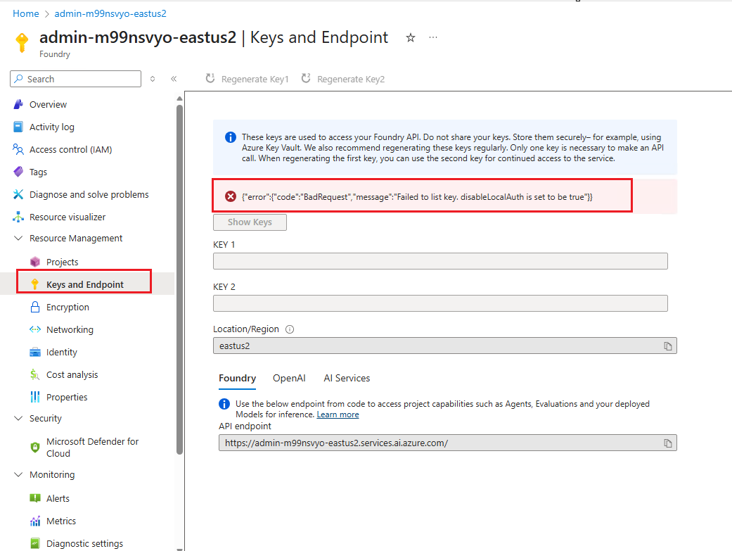

I am connecting to Azure OpenAI but suddently from Dec 30, it shows the error "AuthenticationtypeDisable" message "Key based authentication is disable for this resource".
When checking Microsoft Foundry**| Azure OpenAI,** I noticed "API key authentication is disabled"
But can't enable it again.
Please help to suggest how we can fix it.

    What is happening
    Your Azure OpenAI resource now has API key authentication disabled, which is why requests using apiKey are failing with:
    AuthenticationTypeDisabled – Key based authentication is disabled for this resource
    When this setting is disabled, all API key–based requests are rejected, even if the key itself is valid. This commonly happens when the resource is configured to use Microsoft Entra ID (Azure AD) authentication only, which is now the recommended and more secure approach.
    Why you can’t re-enable API keys

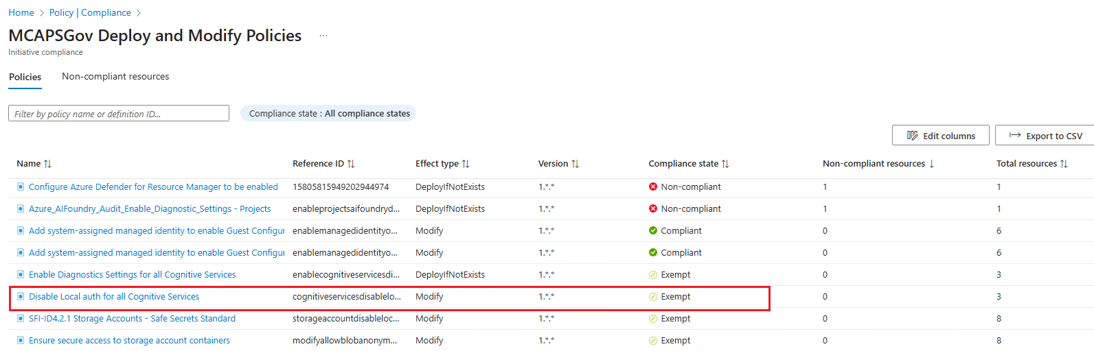

    If the “API key authentication is disabled” toggle cannot be turned back on in Azure AI Foundry or the Azure portal, it usually means one of the following applies:
    An Azure Policy enforces keyless (Entra ID–only) authentication
    The resource was created or migrated with AAD-only authentication enforced
    You don’t have Owner-level permissions to override the policy
    In these cases, the portal intentionally prevents re-enabling API keys.

    If you must use API keys, check whether a subscription-level policy is enforcing keyless authentication (this requires Owner access to change or exempt).
