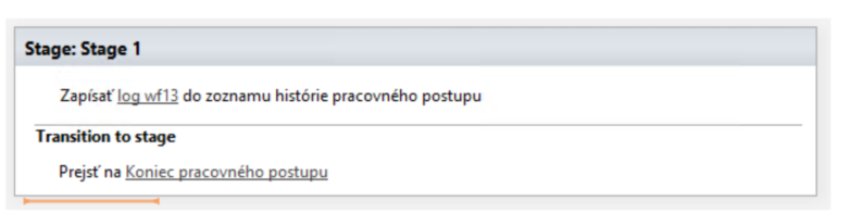

    Workflow 2013 only writes to the workflow history list and then WF cancel:User's image

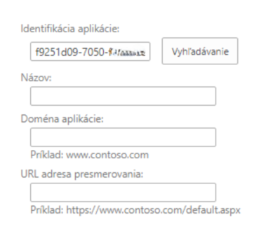

    I don't have any applications available at the URL "https://www.domain.com/_layouts/15/appprincipals?Scope=Web".
    When I go to "https://domain.com/_layouts/15/appinv.aspx" enter the application ID "PII Removed" in the input field, and then click "Search," nothing is returned.
    It still doesn't work for me. Can you tell me where I might be going wrong?
