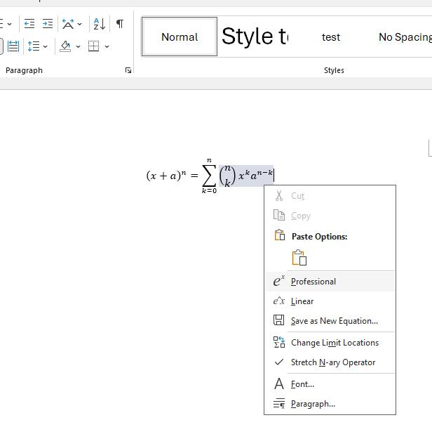

    Based on my test environment, the right-click action and switching between Linear and Professional formats can be performed as shown in the image below:
    Version: 2510 (Build 19328.20266 Click-to-Run)
    If you are unable to switch between these two formats, please check the following:

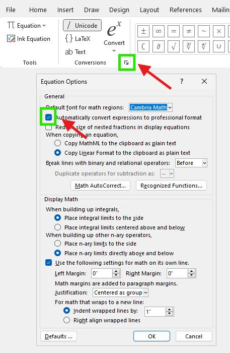

    And if you want formulas to always display in Professional format, please set it up as follows: Click Equation → Conversion → Automatically convert expressions to professional format.

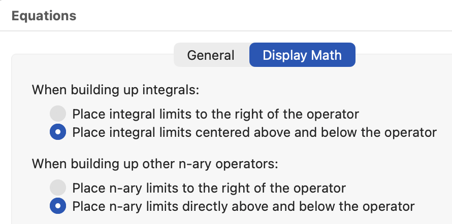

    However, in the Format menu, I can use Equation Options, then I chose
    Note that I unclicked both choices.
    I also chose:
    In both cases, I changed from the first to the second option.
    BUT still, after selecting those formats (either before or after I type the equation) I get the limits to the right of the operator, not above.
