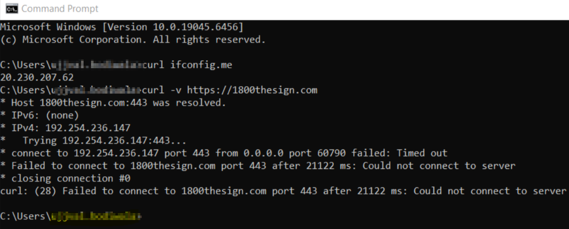

We are unable to access the website from an Azure virtual machine using the public IP address PII.
We have verified the traffic from the website side, and it has been confirmed that the website is not receiving any traffic from this public IP address.
Please assist us in identifying the cause of this issue and advise on the next steps to resolve it.

    5.IP Flow Verify (Network Watcher)
    • Run IP Flow Verify for the VM to check whether outbound traffic on port 443 is Allowed or Denied. This helps determine whether NSG or UDR rules are blocking the traffic.
    6.VM‑level test
    • From inside the VM, please share the output of the below via "Private message":
      1. curl -v https://<target‑website>
      2. curl ifconfig.me (to confirm the outbound public IP used)
