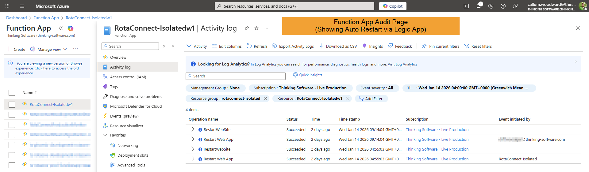

Image one:
This image shows the audited automatic restart at 5 AM of the Function App. And then above it shows us restarting it manually at 9:15 on the 14th of Jan 26 (after we came into the office in the morning and saw everything erroring and had ground to a halt).

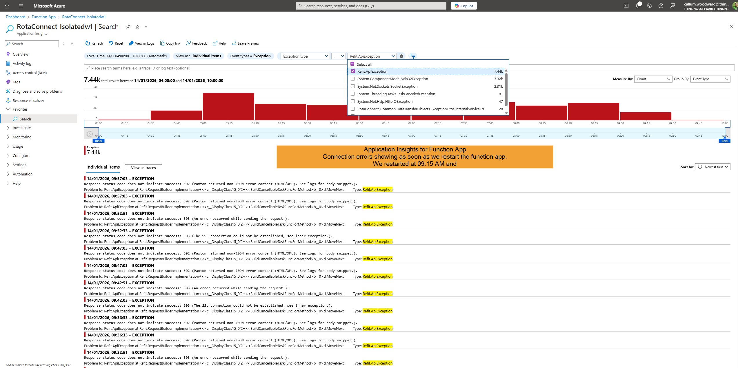

Image two:
Image two shows the error starting (via Application Insights) at the same time the Function App was restarted. And then the errors stopped when we restarted it manually at 09:15 AM.

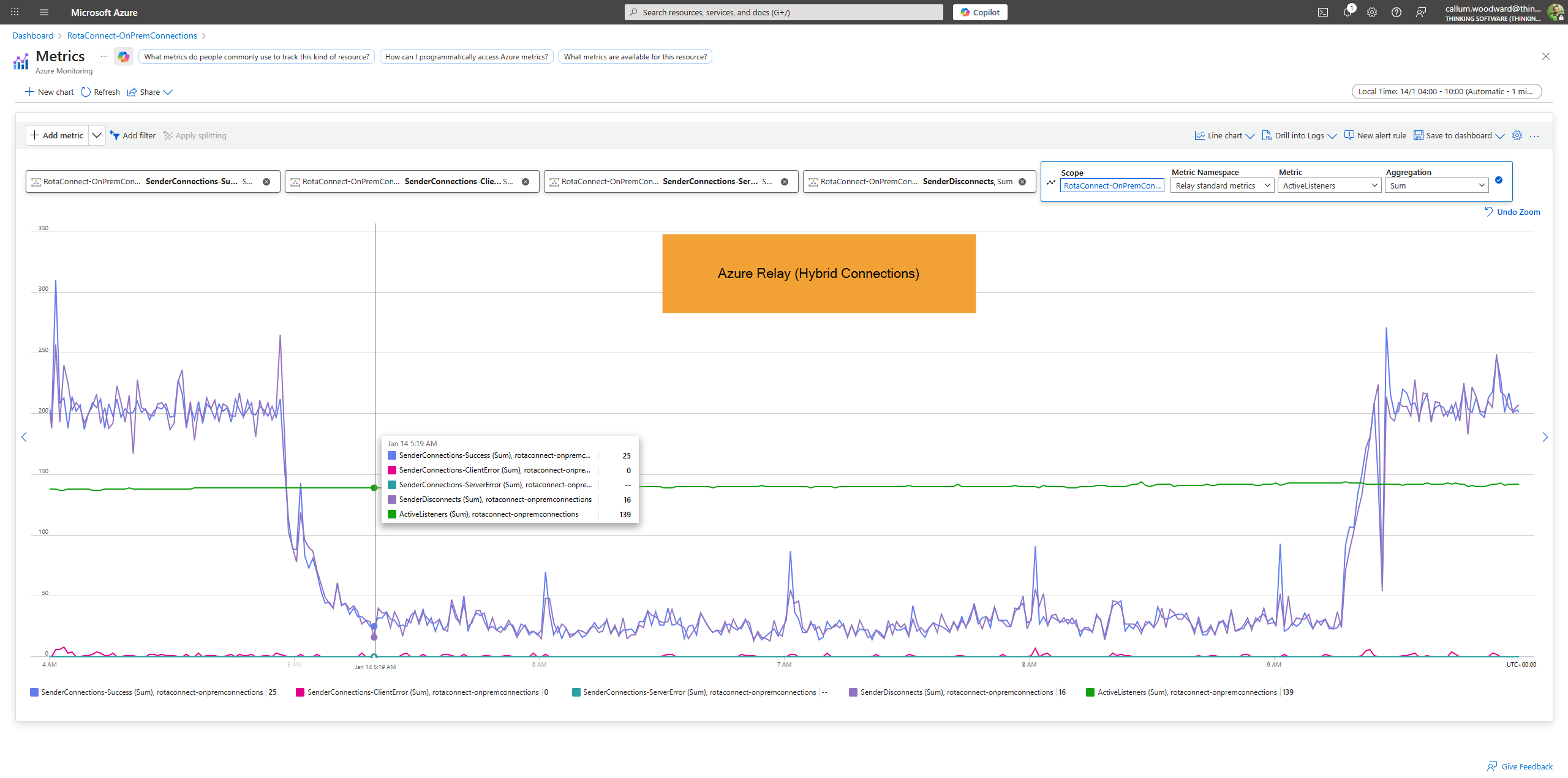

Image 3:
This shows the correlation between restarting the function app and all of the Hybrid Connections "Sender" and "Throughput" going right down. However, you'll see that the Hybrid Connections themselves do not go "Offline".
This can be seen with the last 'green' metric of "Active Listeners".
So, in summary, my theory is this is an internal network routing problem with Azure, between the Function App and the Azure "Relay".
