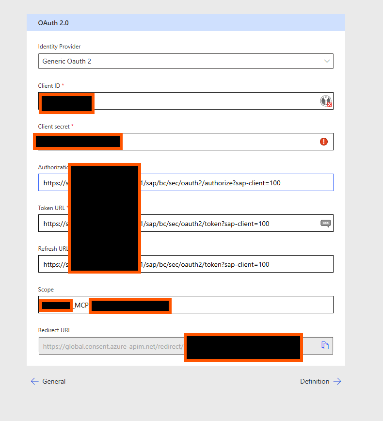

  3. Darius Rohde 0 Reputation points
    2026-02-11T15:01:13.51+00:00
    I have the same isssue, connecting a MCP Server running on SAP. SAP requires the SAP Client ID to be passed as ?sap-client=100
