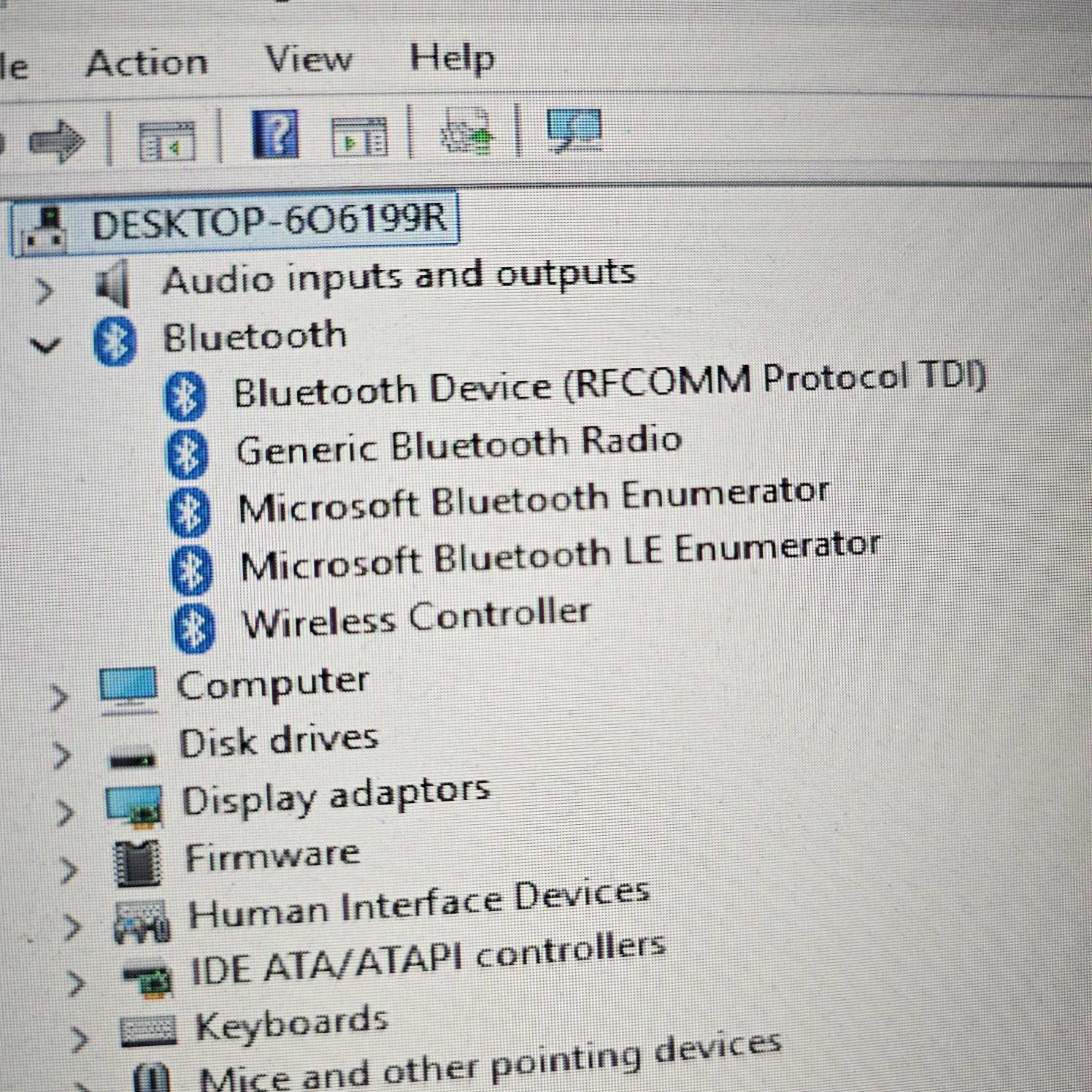

Ps4 controller wont connect to my pc when I brought a bluetooth usb 5.0
Ash suii 40 Reputation points
2026-01-24T12:07:32.15+00:00
I brought a bluetooth usb 5.0 for my pc cause my pc does not have bluetooth and I wanted to connect my ps4 controller to pc I tried to connect it before and it worked the next day I tried to my ps4 controller wont show up.

  2. Ivan B 96,800 Reputation points Independent Advisor
    2026-01-24T12:44:28.7166667+00:00
    In this case, you access the start menu > settings > Bluetooth & Devices > Bluetooth > press the ... Dualshock 4 or PS4 Controller > Select remove device > After removing, put the controller in Pairing mode and readd.
    If you use the PS4 controller on the console, you will have to repeat the above process once more. You don't need to do this if you are not using it on another PC or console.
    Thanks
