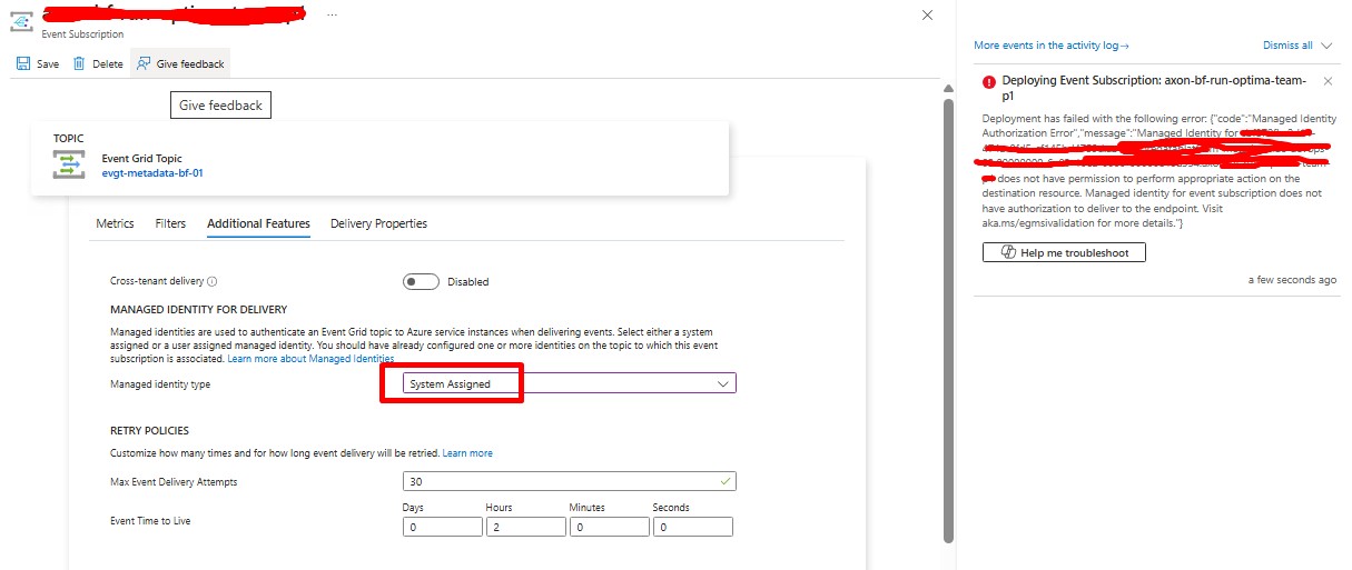

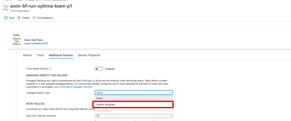

Hi

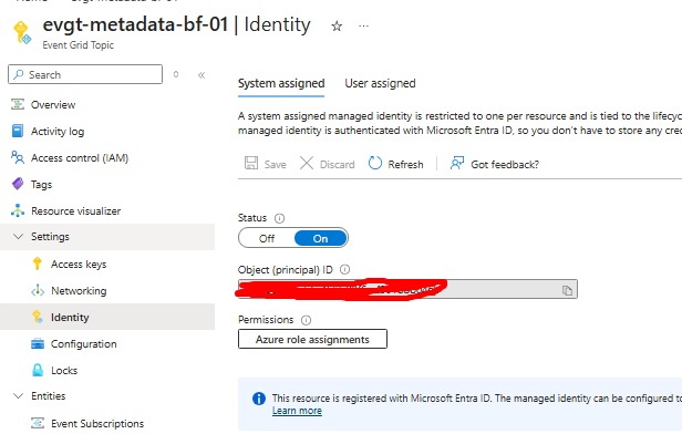

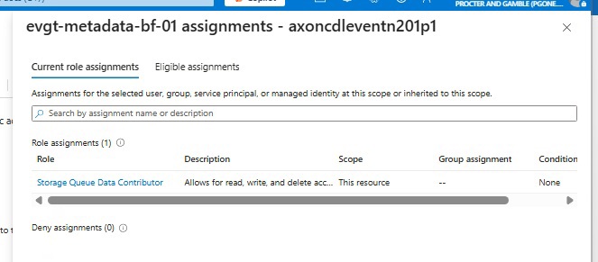

I have an issue. When I'm trying to change existing event subcription Managed identity type from "None" into "System Assigned" I have a following error: "Managed Identity for XXXXX:YYYYY:ZZZZZ:TTTT (hiding for security) does not have permission to perform appropriate action on the destination resource. Managed identity for event subscription does not have authorization to deliver to the endpoint." However I have added "Storage Queue Data Contributor" to service principal associated with Event Grid Topic. What should I do to enable it?

    Root Cause
    When the identity type is switched to System Assigned, Azure creates a new managed identity specifically for the Event Subscription. This identity must have the required data-plane permissions on the destination resource (for example, Storage Queue or Service Bus).
    In this scenario, the role was assigned to the Event Grid Topic service principal, but Event Grid validates permissions using the Event Subscription’s managed identity, which currently does not have sufficient authorization to deliver events to the endpoint.

    Navigate to the Event Subscription → Identity blade.
    Copy the Principal (Object) ID of the System Assigned managed identity.
    1. Assign the appropriate RBAC role to this identity on the destination resource:
      • For Azure Storage Queue: Storage Queue Data Contributor also try with storage data contributor at the storage account scope.
      For Azure Service Bus: Grant Azure Service Bus Data Sender at the namespace scope. If the destination resource has network restrictions or firewall enabled, ensure: Allow trusted Microsoft services is enabled.
        System-assigned identity is being used.
        Wait a few minutes for RBAC propagation, then retry updating the Event Subscription.
