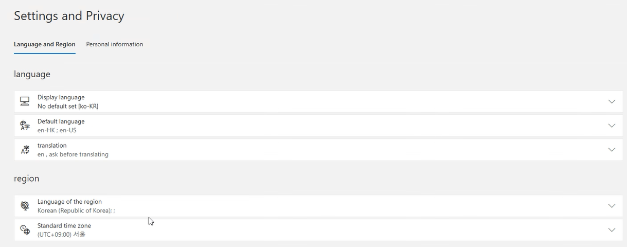

  2. Jiang, Vivian (systemsGo) 0 Reputation points
    2026-02-09T02:53:52.07+00:00
    Hi Expers, thank you for your reply.
    As checked with the user, his timezone already set in exchange side.User's image
