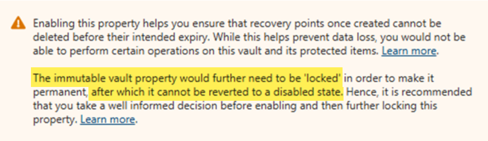

  1. Andreas Baumgarten 131K Reputation points MVP Volunteer Moderator
    2026-02-06T20:31:22.56+00:00
    Hi @marcj ,
    while enabling the "Immutable vault" option did you enable "Locked" option as well?
    If so, the "Immutable vault" option can't be reverted.
    Source: Enable Immutable vault
    You should have seen a warning message when you enable the "Locked" option.
    There are two options if the "Immutable vault" option is "Locked":
    Wait until the retention period of the backups are expired and try to modify the setting or open a support request with Azure Support.
