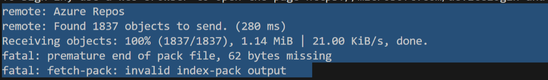

We are having difficulty cloning our repository as shown in the attached screenshot when cloned through Azure Machine Learning terminal:

    I understand you’re hitting a “premature end of pack file / invalid index-pack output” error while cloning a Git repository from Azure Repos using the Azure Machine Learning (AML) terminal. This is a fairly common issue in managed compute environments and is almost never caused by a problem with the repository itself.
    What the error means
    This error indicates that Git started receiving objects from Azure Repos, but the transfer was interrupted or corrupted mid-stream. Azure Repos successfully begins sending objects, but the connection drops or the data stream becomes inconsistent before Git can fully unpack it.
    In Azure ML, this usually points to network instability, transport issues, or resource constraints rather than authentication or repo corruption.
