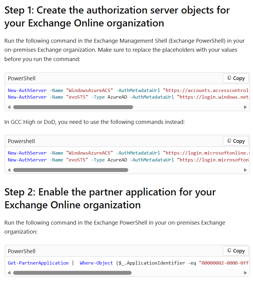

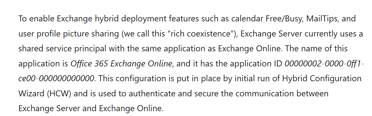

    To begin with, you will need to enable Partner Applications. This step is important because it allows secure authentication and communication between your on‑premises Exchange Server and Exchange Online. One key Partner Application involved in hybrid scenarios is the application ID 00000002-0000-0ff1-ce00-000000000000, which represents the Office 365 Exchange Online hybrid application.
    Reference: Exchange Server Security Changes for Hybrid Deployments | Microsoft Community Hub
    Before enabling it, you will also need to create a new AuthServer. This ensures that the Partner Application trusts the authorization server, as described in step 1 and step 2 of Configure OAuth authentication between Exchange and Exchange Online | Microsoft Learn

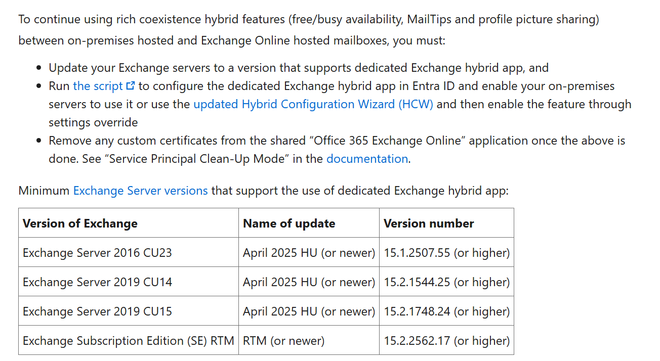

    There is an important point I would like to highlight. Only Exchange Server 2016 CU23 and later versions support the dedicated Exchange Hybrid Application that uses the Partner Application ID 00000002-0000-0ff1-ce00-000000000000
    This is outlined in Dedicated Hybrid App: temporary enforcements, new HCW and possible hybrid functionality disruptions…

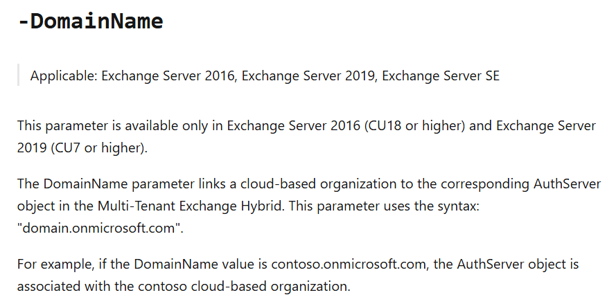

    With this in mind, the error you encountered regarding the property “DomainName” occurs because the New‑AuthServer command did not populate that value correctly. As a result, the Partner Application is unable to complete the authorization process, which ultimately causes the Free/Busy feature to fail.
    To resolve this, upgrading to Exchange Server 2019 CU14 is the recommended path. With this version, the Hybrid Configuration Wizard can automatically establish the required authorization trust between your on‑premises Exchange environment and Exchange Online. Once that trust is created, the Free/Busy feature should work as expected.

    Based on your description, it appears that the Hybrid Configuration Wizard was unable to create the required AuthServer objects, which is why you are seeing the error message. To verify this, you can run the following PowerShell command:
    Get-AuthServer
    If the command returns no output, it indicates that the AuthServer objects are missing. In that case, you may consider creating them manually using these examples:
    New-AuthServer -Name "WindowsAzureACS" -AuthMetadataUrl "https://accounts.accesscontrol.windows.net/<your tenant initial domain>/metadata/json/1"
    New-AuthServer -Name "evoSTS" -Type AzureAD -AuthMetadataUrl "https://login.windows.net/<your tenant initial domain>/federationmetadata/2007-06/federationmetadata.xml"

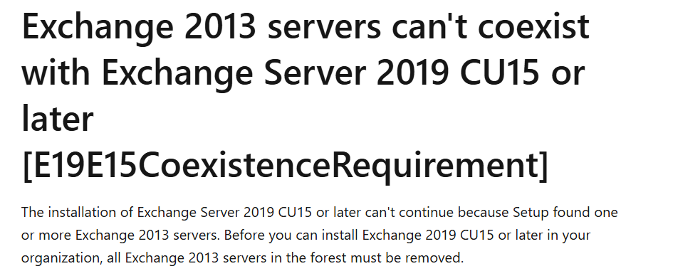

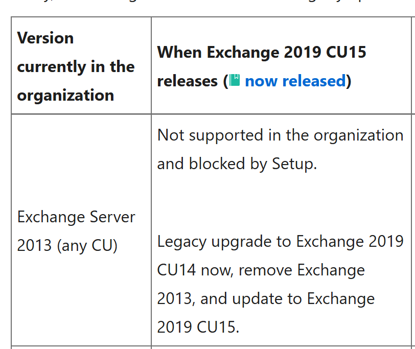

    Additionally, based on my research, Exchange Server 2019 CU15 (the latest CU) does not support coexistence with Exchange Server 2013.
    The supported upgrade path from Exchange Server 2013 to Exchange Server 2019 is shown in the image below:
    Legacy upgrade – the traditional way of moving to a new major version of Exchange Server. It requires introducing the newer server into the organization, moving all mailboxes and resources from older servers to new servers and uninstalling the old servers.
    With that in mind, if you are planning to upgrade to Exchange Server 2019 in the near future, you may consider proceeding with the upgrade to help address the HCW error “Could not find property ‘DomainName’”. The -DomainName parameter in New‑AuthServer is supported only in Exchange Server 2016 CU18 or later and Exchange Server 2019 CU7 or later. Having a supported version in place can allow the HCW to create the AuthServer properly and help prevent issues where online users are unable to access on‑premises calendar information.
