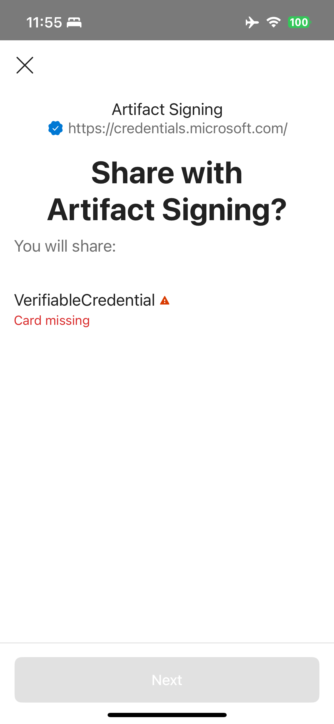

I have a Trusted Signing account (Organization, Public) with identity validation stuck in "Action Required" state.
When I click the verification link and scan the QR code with Microsoft Authenticator, it shows:
"VerifiableCredential Card missing"
Under the Verified IDs tab in Authenticator, there is nothing - just "Scan QR code". No credential has been issued.
Setup:
  • Azure account signed in with Gmail
    • Country: Canada
  • Authenticator has both my personal account and a work account (@**********.onmicrosoft.com)
  • Tried scanning with both accounts active How do I get past this step?

    I found the solution to this: you need to first establish a "Verified ID" in the Authenticator app. That is presumably the "card missing" that the error message is referring to.
    To establish a Verified ID, follow the link under the Azure verification QR code that says "Don't have a Verified ID? Get verified here through our trusted ID-verifiers."
    Here in the US, that link took me to a URL at a site called au10tix.com. From there, it took maybe 5 minutes to complete that process, including scanning in some government ID and taking a selfie.
    Once done, it presented its own QR code, which the MS Authenticator app scanned to create a "Verified ID" in its wallet. Then I could double back to the QR code for Azure's identity validation, and it accepted it this time.
