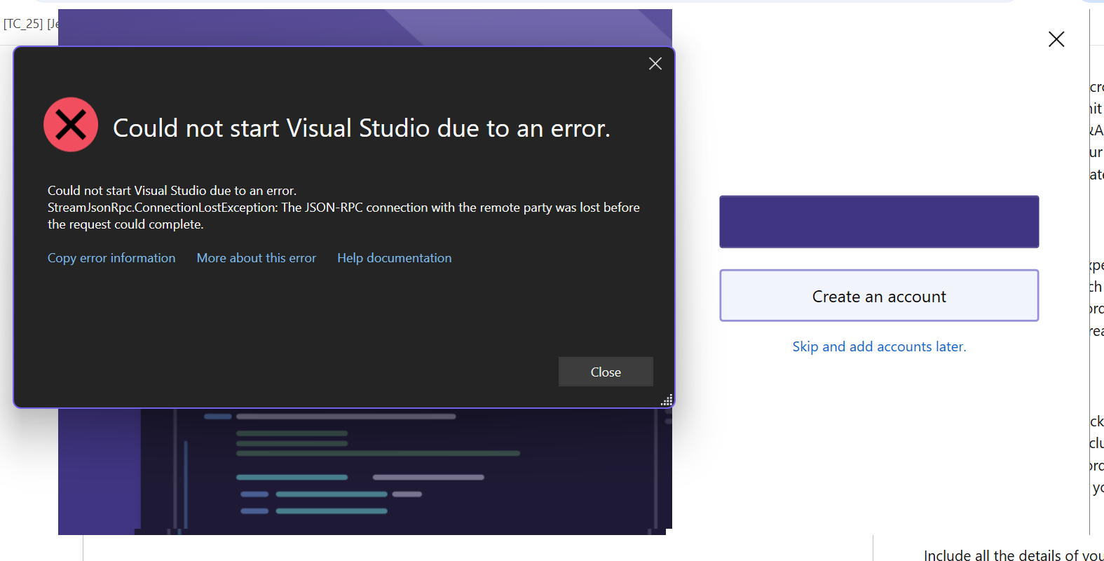

Could not start Visual Studio due to an error. StreamJsonRpc.ConnectionLostException: The JSON-RPC connection with the remote party was lost before the request could complete.
Jaswanth Arla --CNTR 0 Reputation points
2026-02-09T16:15:01.86+00:00
Getting the following error while launching the newly installed visual studio 2022
Developer technologies | Visual Studio | Setup

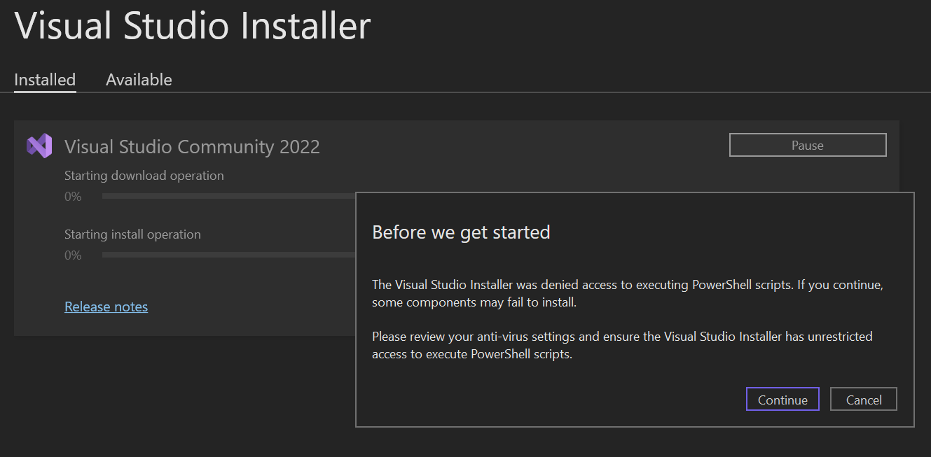

  1. Jaswanth Arla --CNTR 0 Reputation points
    2026-02-12T10:46:23.1733333+00:00
    While trUser's image
    ying to repair getting this error, but I don't see any restrictions in my settings. Also, no issue with visual studio 2026, but as I need 2022 version.

    Hi @Jaswanth Arla --CNTR ,
    Thank you for sharing the screenshot. Based on the error message shown, Visual Studio is failing to start due to the following exception:
    StreamJsonRpc.ConnectionLostException:  The JSON‑RPC connection with the remote party was lost before the request could complete.
    This error indicates that one of those background services crashed or failed to initialize during startup, causing Visual Studio to lose communication with it and shut down.
