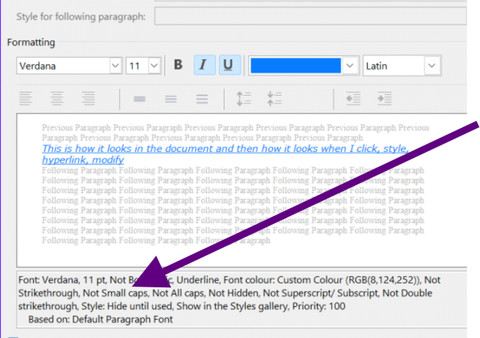

IN a document, hyperlinks suddenly became small caps! I tried all advice through google and chat GPT in vein!
I tried modifying the global style (I have so many links in the doc so cannot go one by one). It shows fine in the style review but not in the real document!

  1. Stefan Blom 335K Reputation points MVP Volunteer Moderator
    2026-02-12T13:03:08.4166667+00:00
    Looking at the Modify Style dialog box in your screen shot, the "Not Small caps" entry in the description of the Hyperlink style is a clue, because it indicates a conflict of settings. "Small caps" is a toggle. Maybe it has been turned off in the Hyperlink style but enabled elsewhere. Investigate other styles, such as the Normal style or any other relevant styles in your document, and you may find the source of the Small caps.
  2. Stefan Blom 335K Reputation points MVP Volunteer Moderator
    2026-02-12T12:17:13.1033333+00:00
    Thanks but did not sort the problem
    Could you clarify which observations you made? For example, do you not see small caps in either of those styles? Formatting can be inherited from another style (see the "based on" setting in the Modify Style dialog box).
    If you want to, you can share a representative sample document with the forum, so that we can have a closer look. Upload it to (say) OneDrive or Dropbox and post a download link in this thread.

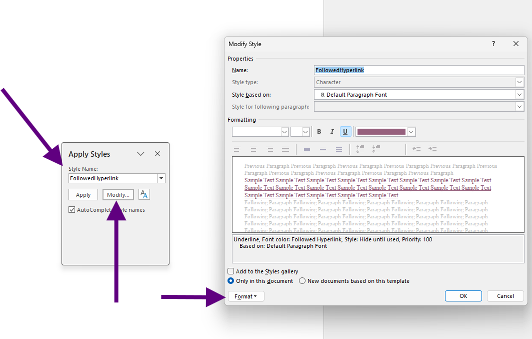

  3. Stefan Blom 335K Reputation points MVP Volunteer Moderator
    2026-02-09T21:20:10.3966667+00:00
    You should verify the settings of the Hyperlink style, as others have suggested. However, there is a second style to consider: the FollowedHyperlink style. These two will control how hyperlinked text appears in Word.
    To access the Modify Style dialog box, you can do the following: In the Apply Styles pane (Ctrl+Shift+S), type in FollowedHyperlink and click Modify.
    In the dialog box, click the Format drop down and then choose Font. Make the desired changes.
