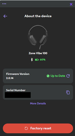

Hello,
My Zone Vibes 100 audio device works fine with teams, except for the Mute button sync. Previously I could flip the microphone back and forth on the device and Teams would sync accordingly, but not any longer. I am running Windows 11 Enterprise

    1/ First, please confirm that the headset is still being managed through Logi Tune:
    You mentioned that the firmware is already up to date (version 2.0.14), which is great. However, Teams relies on Logi Tune for proper integration and HID controls, so it’s important to ensure the device is actively recognized there.
    Open Logi Tune and verify that the Zone Vibe 100 appears correctly. If everything looks fine, try fully quitting and restarting Logi Tune to refresh the connection.

    Great! Thanks Killian. Step 2 worked! Mic button on Teams now syncs to the headset like before.
    One thing I should've mentioned previously (maybe this is the culprit), I actually have been using 2 Zone Vibe 100s, one for my home office and one for my desk office. Same computer each time, I just keep two headsets so I don't have to bring them back and forth with me. I just unpaired my desk office headset and repaired the home headset, which is now syncing with Teams.
    I will be back in the office next week, will see if pairing the 2nd headset messes up the situation.
