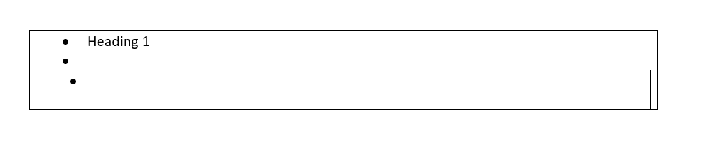

The following is a screenshot of one of the problems that happen when I try insert a bullet point in a table that is within another table:
Bullet_point_problems
In the screenshot above a second bullet point randomly gets printed on the top of the innermost table

    I can replicate the issue with the application of bullets to text that is located in a table that is within a table and have reported it directly to the Microsoft Word Product Team.

    I am currently facing the same issue. Please expedite the fix.
    Current workaround that works for me:
    Turn off Automatic bulleted lists and Automatic numbered lists.
    1. Go to File > Options > Proofing.
    2. Click AutoCorrect Options and select the AutoFormat As You Type tab.
    3. Uncheck Automatic bulleted lists and Automatic numbered lists. After that I am able to use the bullet/numbered command buttons on the ribbon like usual.
