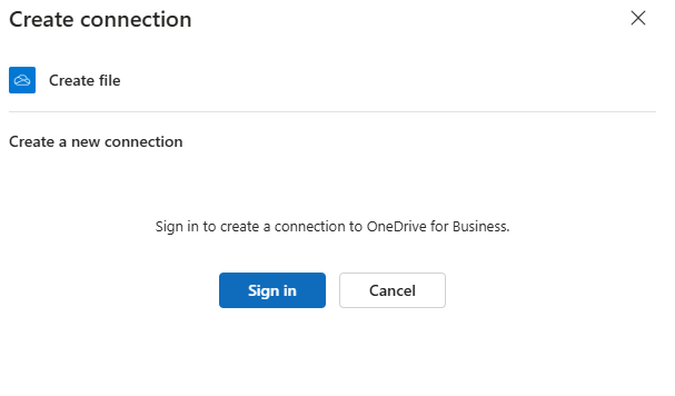

If i want to use one drive for business with logic app, what connection methods are possible

    Hello DiyaPS-5330,
    Option 1:
    If you are using the built-in OneDrive for Business connector in Azure Logic Apps, the supported connection method is:
    Authentication type:
    OAuth 2.0 using an Azure AD work or school account (user-delegated permissions).
    The connection is created by signing in with the user’s organizational account, and Logic Apps securely stores this connection for subsequent actions and triggers.
