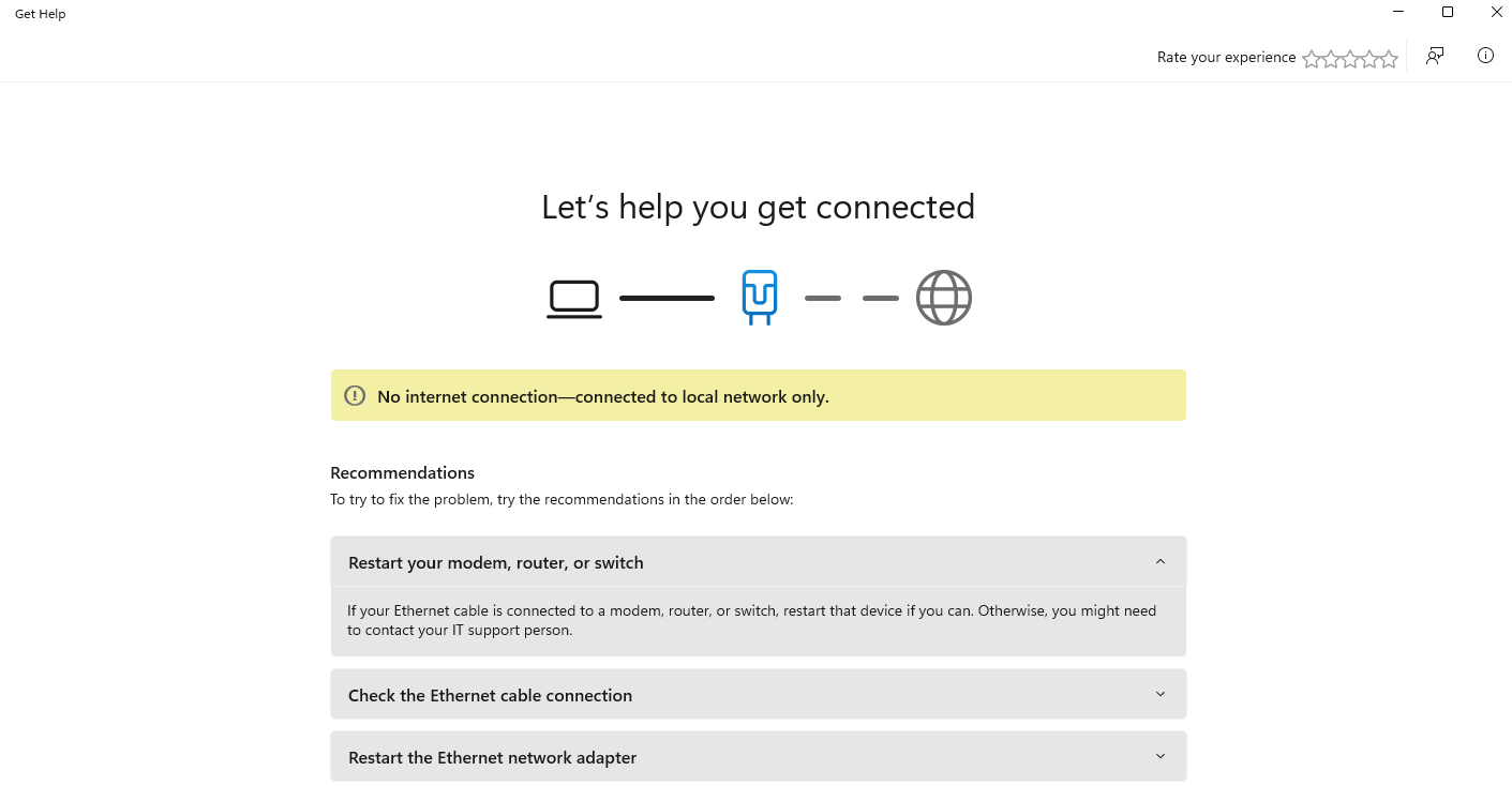

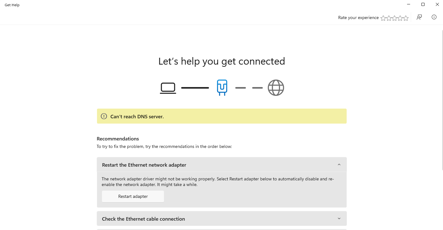

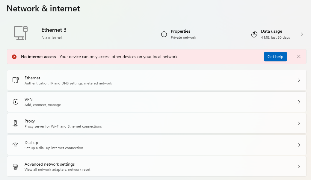

I've encountered a crash without warning while I was looking through my images, my monitor first went dark and than restarted, and it crashed again. After awhile of waiting, the login screen reappeared but I wasn't able to connect to the Internet again, after resetting, restarting my router, plug and unplugging my ethernet cable, none worked. I realized that I could be a corrupted system executables and libraries and i decided to run SFC and DISM. SFC showed up with "no integrity violation found" and DISM completed successfully. I restarted it, it did not work so I turned to in place repair. I took my laptop and downloaded the latest Multi-edition ISO from the official site for Windows 11 and transferred the ISO to my desktop using USB. I made sure I've uninstalled all of the external anti-viruses and VPNs before anything, killed off unnecessary processes. In the in place repair options, I chose not to update drivers and windows since I had no internet access. Kept all my programs and files and let it do its job. After the blue phase of the repair is done and restarted my device, the percentage went up to 23% then restarted again, and then "Undoing changes made to your computer" showed up and brought me back to the login screen along with phantom typing on my keyboard, managed to partially fixed it and later after logging into my account "We couldn't install Windows 11 - We've set your PC back to the way it was right before you started installing Windows 11 - 0x8007042B - 0x2000D The installation failed in the SAFE-OS phase with an error during MIGRATE_DATA operation", I found out that there was a error icon within the device manager for the Intel ethernet driver so I reinstalled it and it had not helped. I did managed to get some logs. (setuperr.log) My only hope is to preserve my 10 Terabyte archive along with my programs. I do not have enough things to fully backup everything.

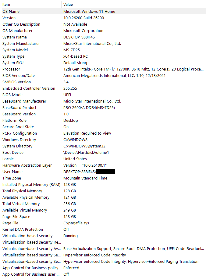

    It is the same error :(
    Please supply the following Information.
    Right-click the Start button and Choose the Run option
    Type in msinfo32
    Press enter.
    Take a screenshot of the System Summary window and post it in the next reply.
    I look forward to your response and am eager to collaborate until we find a solution.
