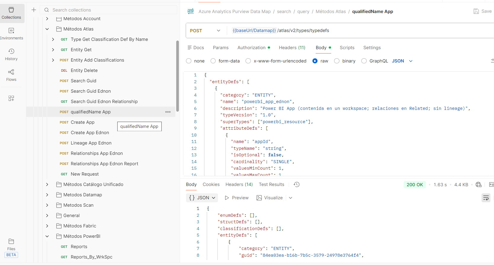

  1. Custom entity type creation I created a custom entity type (powerbi_app_ednon) derived from powerbi_resource.

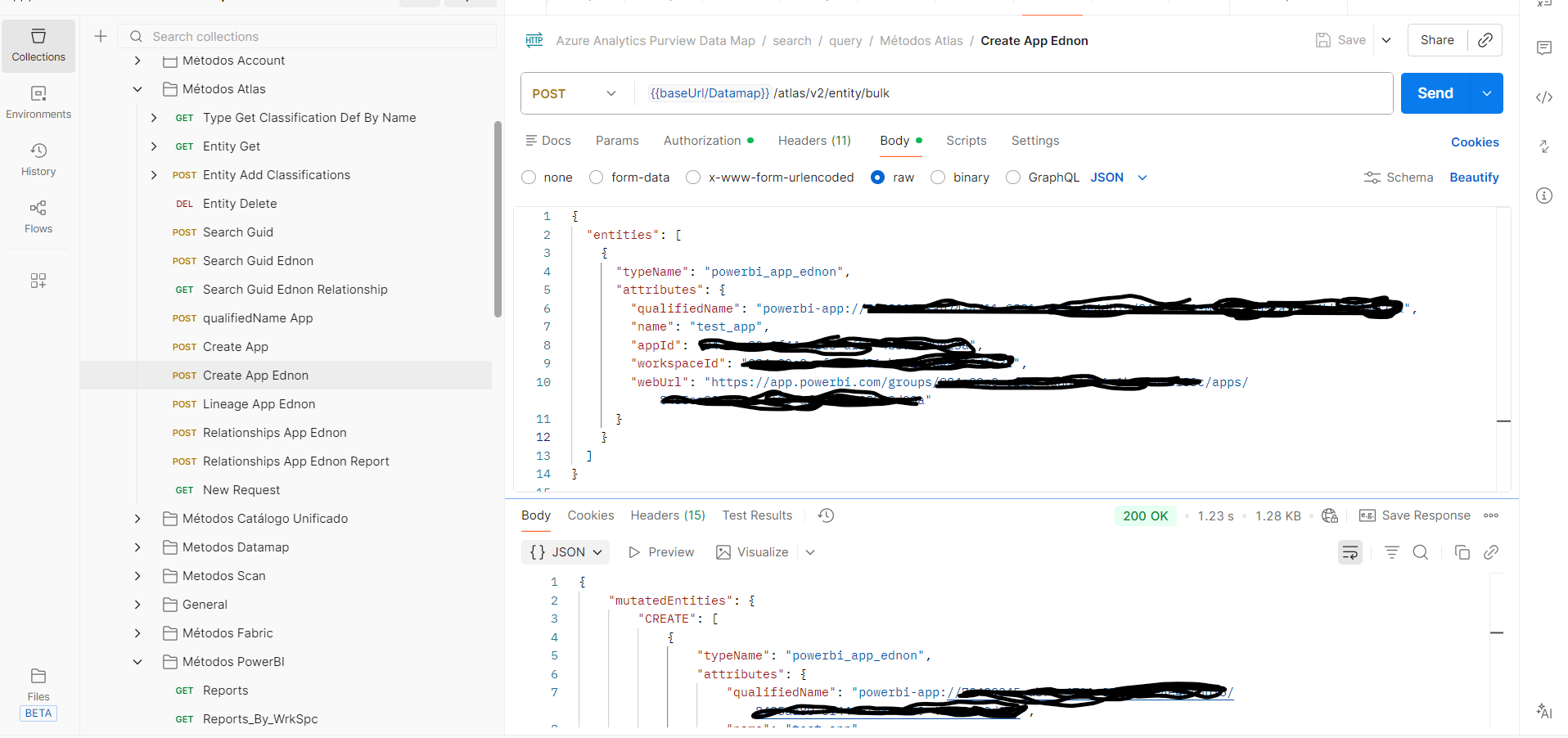

  2. App entity creation I created a Power BI App entity using: POST /atlas/v2/entity/bulk With attributes including:
    • qualifiedName (powerbi-app://…)
    • appId
    • workspaceId
    • webUrl
    • name

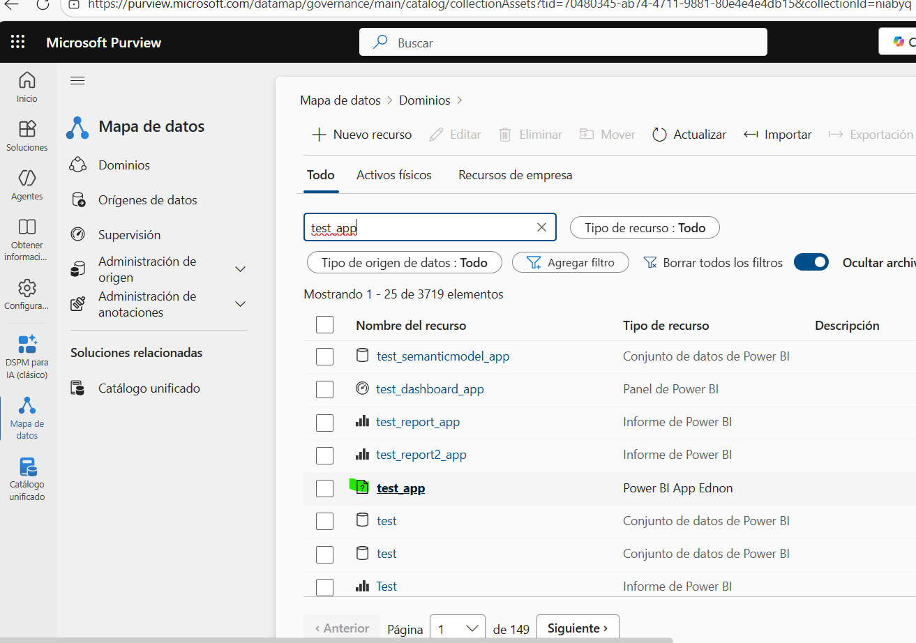

    The app entity is successfully created and visible in the Purview catalog.

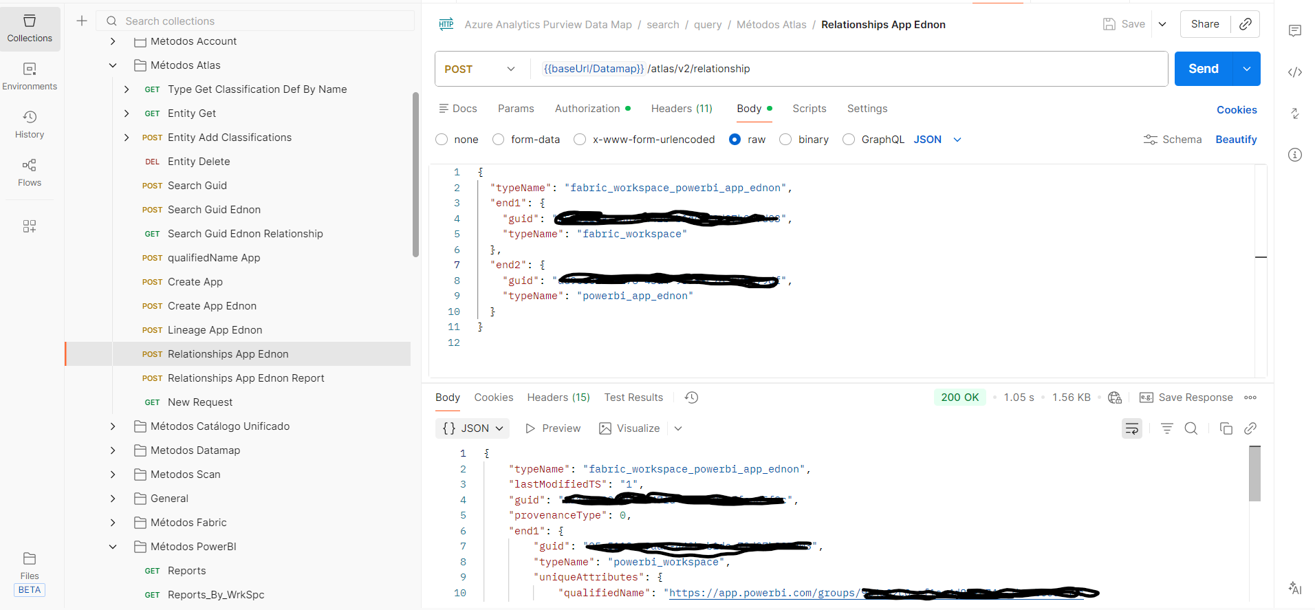

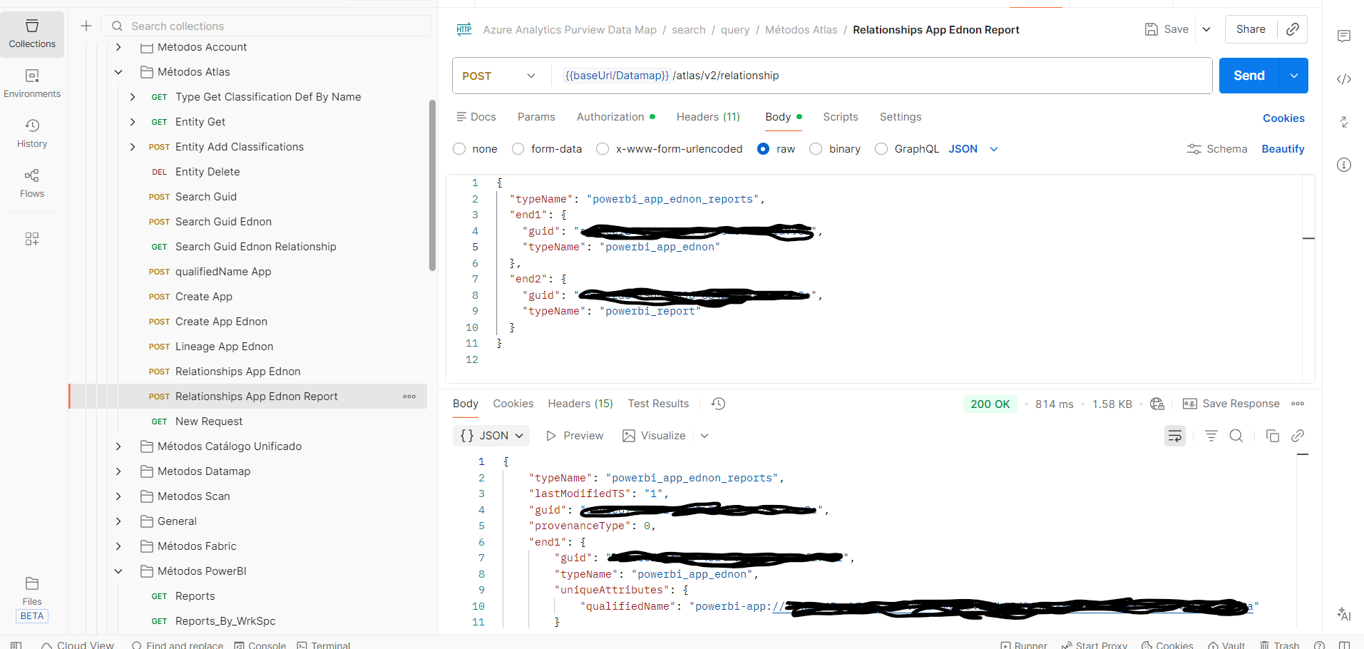

  3. Workspace → App relationship I created a relationship between the Fabric workspace and the app: POST /atlas/v2/relationship typeName: fabric_workspace_powerbi_app_ednon The workspace correctly shows the app under Related resources.
  4. App → Report relationship I created another relationship: POST /atlas/v2/relationship typeName: powerbi_app_ednon_reports linking the app to an existing Power BI report.

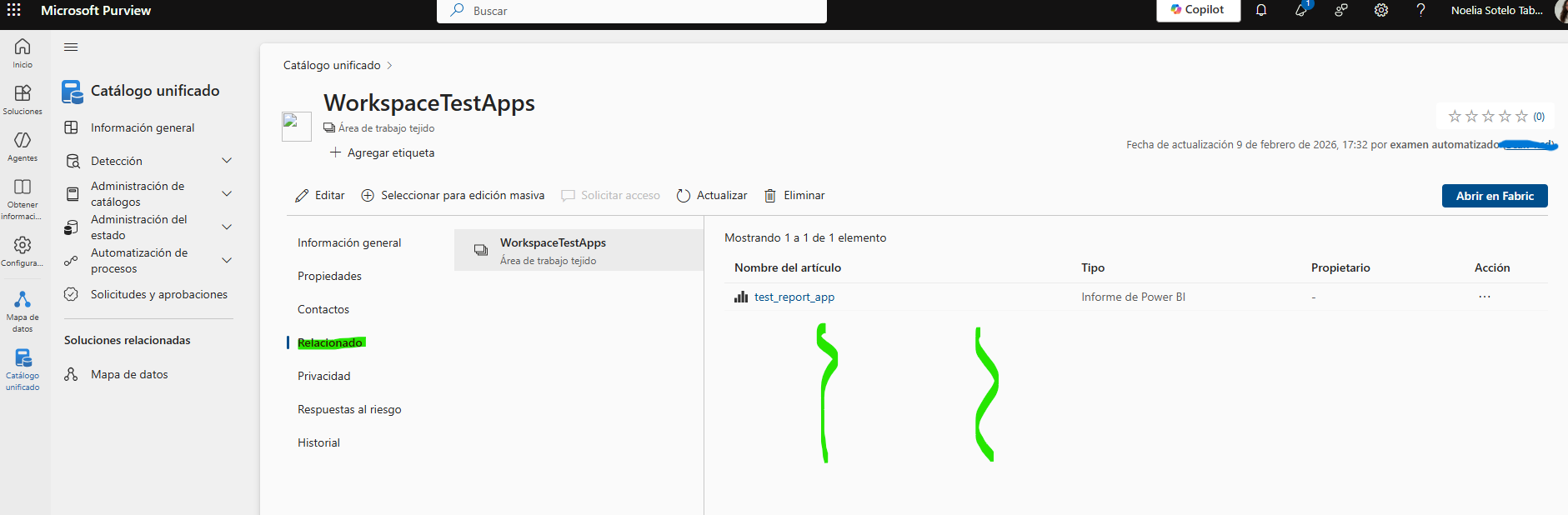

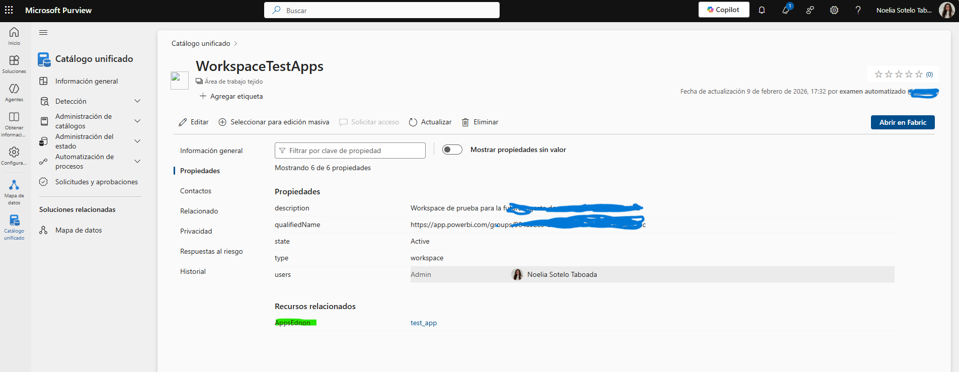

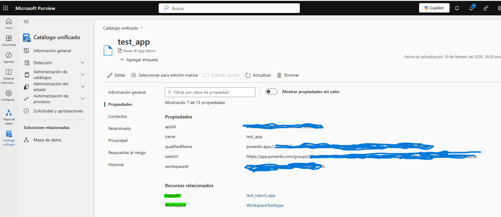

When I open the App entity in Purview, I can see:
  • The related report
  • The related workspace

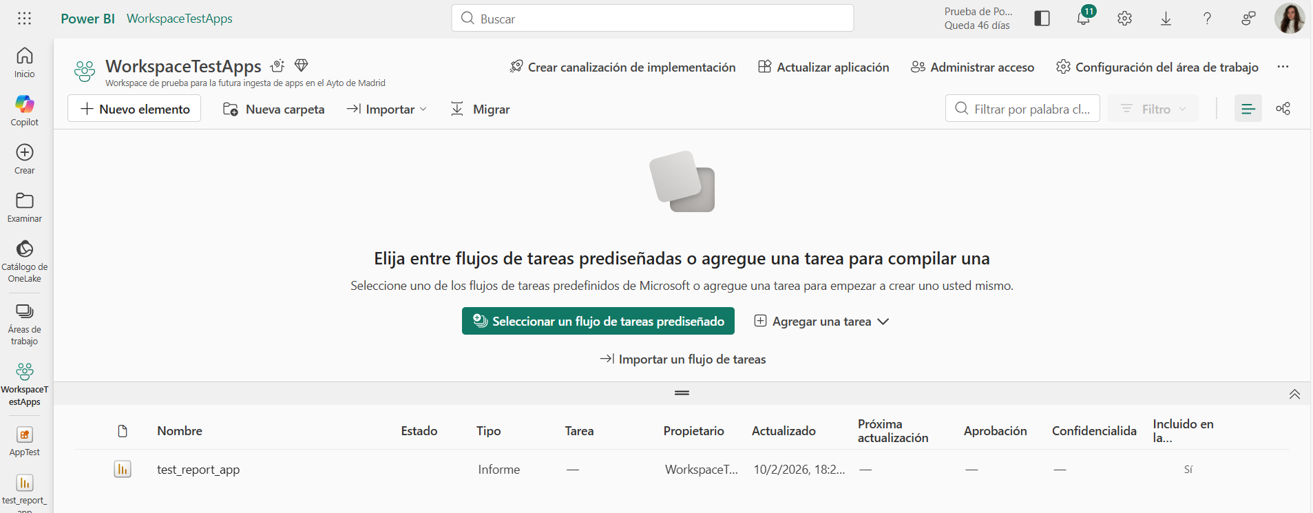

However, when I open the Workspace and go to the Related tab (the section highlighted in green in the attached screenshots), I only see the report. The app does not appear in that same list where I would expect it to be shown.

  • The API requests used to create the entity and relationships

Query:
  "entityDefs": [
      "category": "ENTITY",
      "name": "powerbi_app_ednon",
      "description": "Power BI App (contenida en un workspace; relaciones en Related; sin lineage)",
      "typeVersion": "1.0",
      "superTypes": ["powerbi_resource"],
      "attributeDefs": [
          "name": "appId",
          "typeName": "string",
          "isOptional": false,
          "cardinality": "SINGLE",
          "valuesMinCount": 1,
          "valuesMaxCount": 1,
          "isUnique": false,
          "isIndexable": true
          "name": "workspaceId",
          "isUnique": false,
          "isIndexable": true
          "name": "webUrl",
          "isOptional": true,
          "valuesMinCount": 0,
          "isUnique": false,
          "isIndexable": false
  "relationshipDefs": [
      "category": "RELATIONSHIP",
      "name": "fabric_workspace_powerbi_app_ednon",
      "relationshipCategory": "COMPOSITION",
      "endDef1": {
        "type": "fabric_workspace",
        "name": "appsEdnon",
        "isContainer": true,
        "cardinality": "SET"
      "endDef2": {
        "type": "powerbi_app_ednon",
        "name": "workspace",
        "isContainer": false,
      "name": "powerbi_app_ednon_reports",
      "relationshipCategory": "ASSOCIATION",
      "endDef1": {
        "name": "reports",
      "endDef2": {
        "type": "powerbi_report",

    Even though the custom powerbi_app_ednon entity is created successfully, the relationships return HTTP 200, and the App entity correctly shows the related Workspace and Report, Microsoft Purview does not display custom Power BI App entities inside the Workspace → Related section of the UI.
    Purview only renders Microsoft‑supported, scanner‑discovered Power BI artifacts in that area—such as Reports, Dashboards, Datasets, Dataflows, and Datamarts. Power BI Apps are not part of the supported Power BI artifact list and therefore do not appear in the Workspace “Related” tab, even when the relationships exist and are stored correctly in the Data Map.
    Your JSON model, entity type, and relationships are valid. The screenshots you shared confirm that the App entity is created correctly, the Workspace relationship exists, and the App entity view displays all expected links. The limitation is strictly in the Purview UI rendering layer, not in your configuration.
