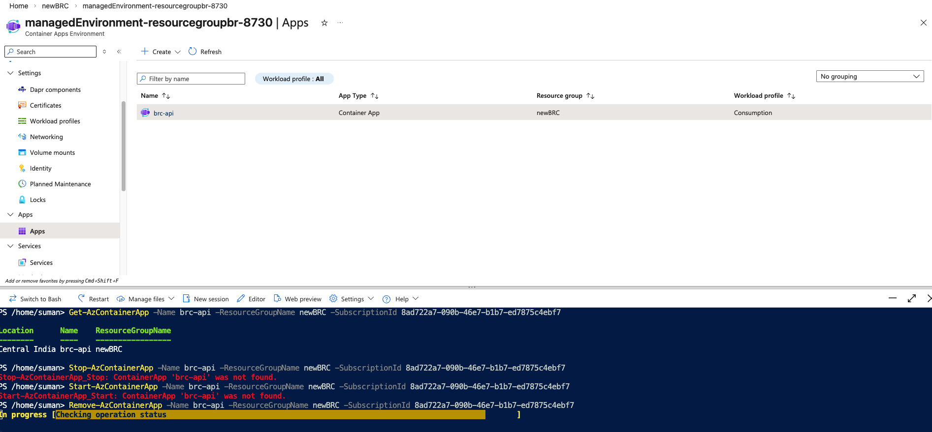

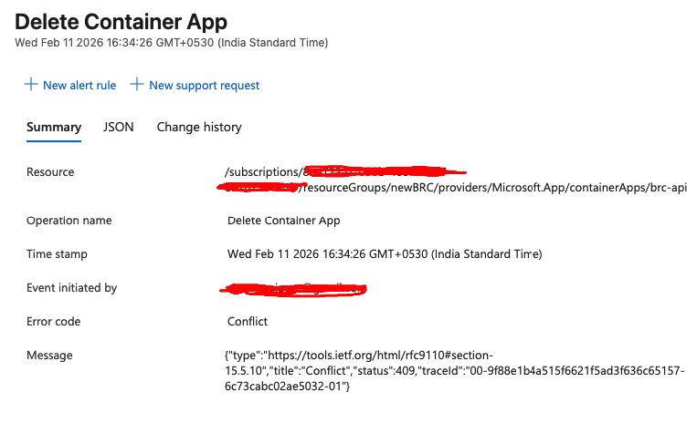

I had created a container app and tested it. But now I am not able to delete it.
I have deleted all the resources in the resource group but still not able to delete this container app.
I also tried to move this container app to other new resource group and then tried to delete it but still unable to delete it.
I am not sure if I am still paying for that resource of not.

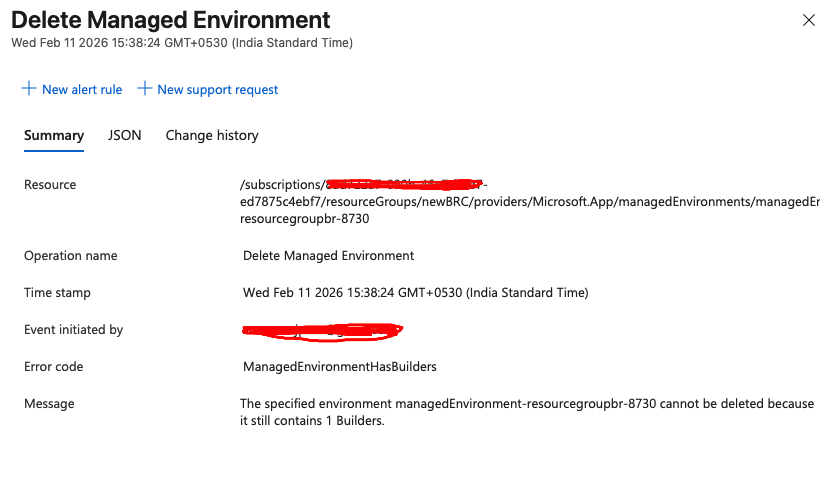

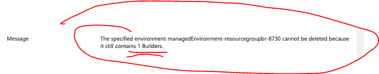

    As per the system design, a managed environment that is referenced by a builder resource cannot be deleted. In your case, the builder bxxxxxxa6 references the managed environment you are trying to delete.
    • If you want to delete the managed environment, the dependent builder resource must be deleted first.
    • If you intend to continue using the builder, the managed environment cannot be deleted, as it is a hard-linked resource required for the builder to function. Deleting it while the builder exists would make the builder non-functional.

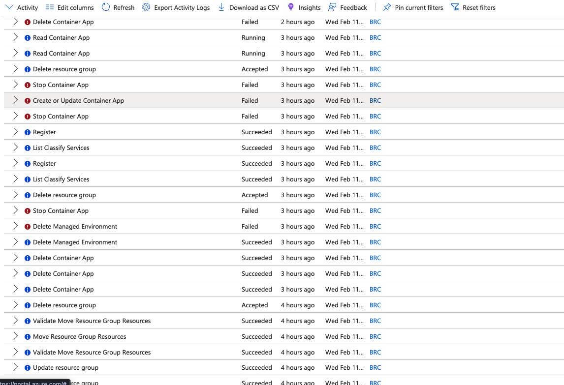

    I encountered a similar issue where I couldn't delete a Container App Environment because it reported having container apps.
    I suspect the resource group containing the container apps was deleted before the apps themselves were properly removed. This left orphaned metadata in ARM that the environment still referenced.
    So I tried 'Overwrite and Delete'. I recreated the missing resource group, recreate the container app with the same name (this overwrites the orphaned metadata with valid state), and then delete the container app.
    This unblocked normal deletion and allowed me to finally delete the environment.

    I would first check that I am in the correct subscription. It is very easy to switch subscriptions in the Azure portal without noticing. Sometimes the container app is actually in another subscription even if the resource group name looks the same.
    Then check whether the Container Apps environment still exists. In Azure Container Apps the app depends on the environment. If the environment is still there or stuck in a deleting state, the app may not be removable. Try deleting it using the Azure CLI instead of the portal, because sometimes the portal just does not refresh properly.
    az containerapp delete --name <app-name> --resource-group <rg-name> --yes

    If there is an exact error message when trying to delete it, that would help understand what is really happening. If there is an error message when you try to delete it, sharing that would help.
