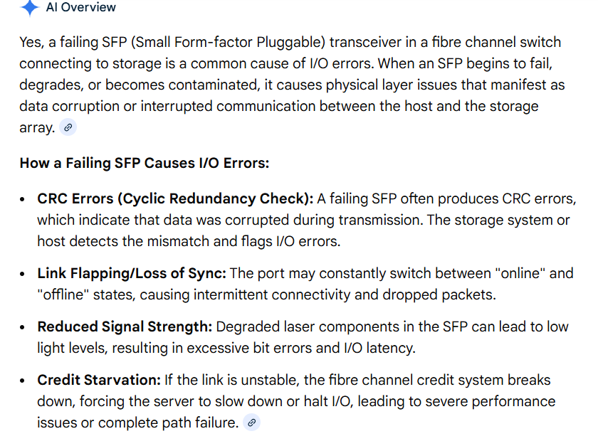

  1. Saransvan 111 Reputation points
    2026-02-16T11:38:33.2366667+00:00
    The cause was a failing SFP as per below. It was nothing to do with Defender which we managed to rule out by running logs.
