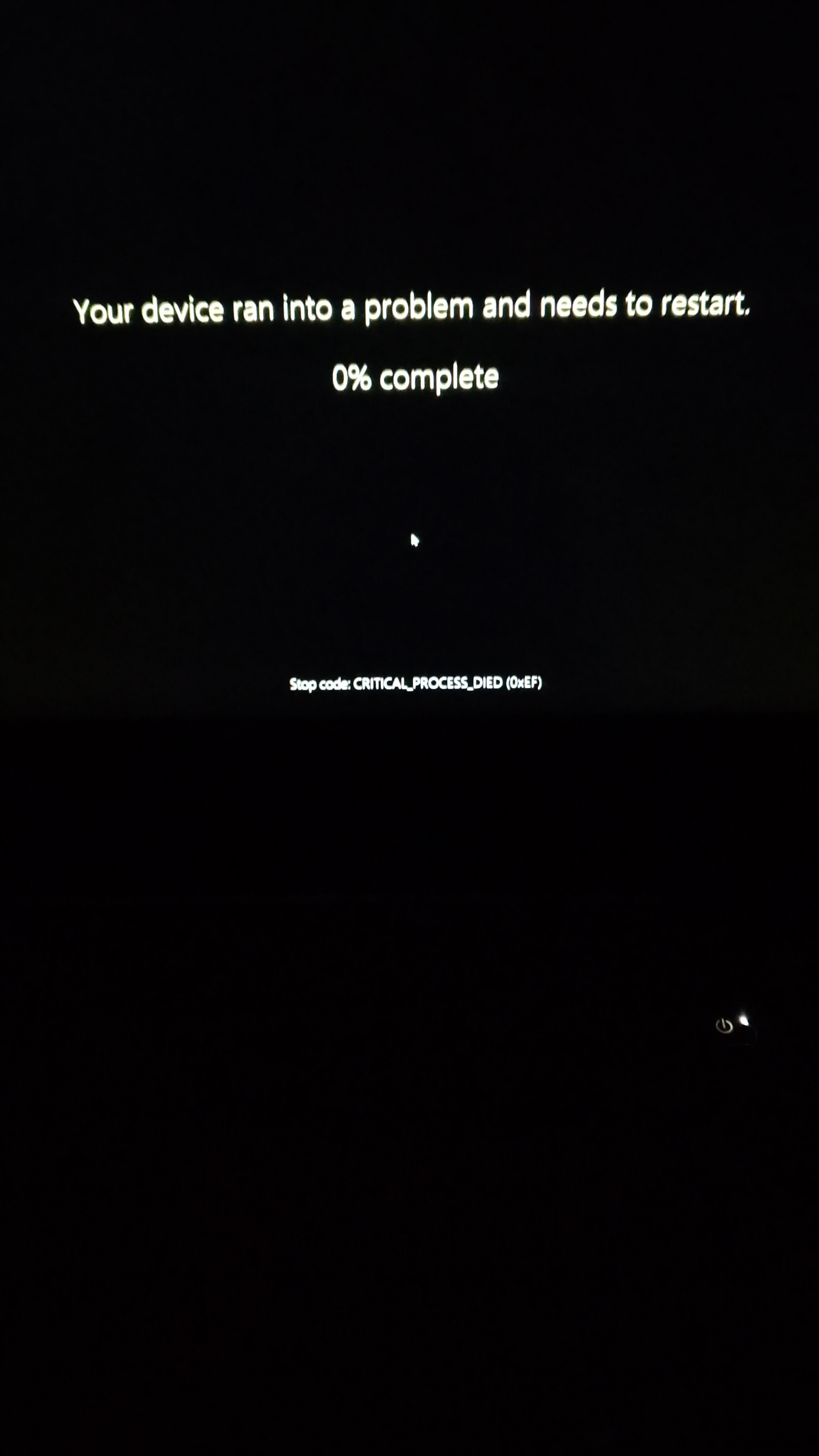

During the course of normal use, while I am playing a game, watching my video player, or basically doing anything (writing, etc), my system would freeze, and then moments later, it would jump to a black screen with the words 'Your PC has run into an error and needs to restart.' Under that, '0% complete'. And at the bottom, it says, 'Stop Code:' some words in all caps, often it's 'CRITICAL_PROCESS_DIED (0xEF)', sometimes it's something different. Sometimes, the system would restart on its own, but most of the time, the screen stays like that, and I have to manually restart (by pressing the power button. This started on Monday (2/9), the morning after I had received a big update. I tried re-installing Windows 11 (I don't know if that was complete, it took about two hours, and the system crashed a couple of times during the process), I tried downloading any new update available, etc etc. My system froze and black screened about ten times that morning, and has done so several times earlier today. It would work just fine for a time and then would crash very unexpectedly. I could use it for hours and it would not crash, then it would crash. I am at my wits' end. Thanks for any advice you have.

    Please check to see if your PC is producing any minidump files, I will check those to see if they provide any insight into a potential cause of the system crashes.
    Please do not upload a very large Memory.dmp file.
    Open Windows File Explorer.
    Navigate to C:\Windows\Minidump
    Copy any minidump files onto your Desktop, then zip those up.
    Upload the zip file to the Cloud (OneDrive... etc.), then choose to share those and get a share link.
    Then post the link here to the zip file, so I can take a look for you.
