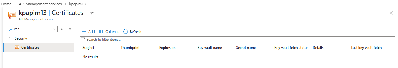

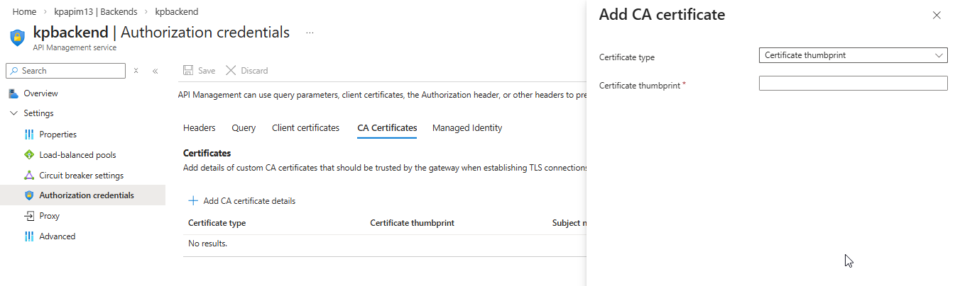

We are running a Standard v2 tier APIM.
One of our backends uses a private CA to sign its cert. I have followed the Microsoft documentation here: https://learn.microsoft.com/en-us/azure/api-management/backends?tabs=portal
The private CA thumb print has been captured against the backend and the backend referenced in the inbound policy for the API.
Yet when invoking the API I still get the error below:
	"messages": [
		"Error occured while calling backend service.",
		"The remote certificate was rejected by the provided remoteCertificateValidationCallback."
Feels like I am missing a config step. Surely the cert itself needs to be imported somewhere?
Please help.

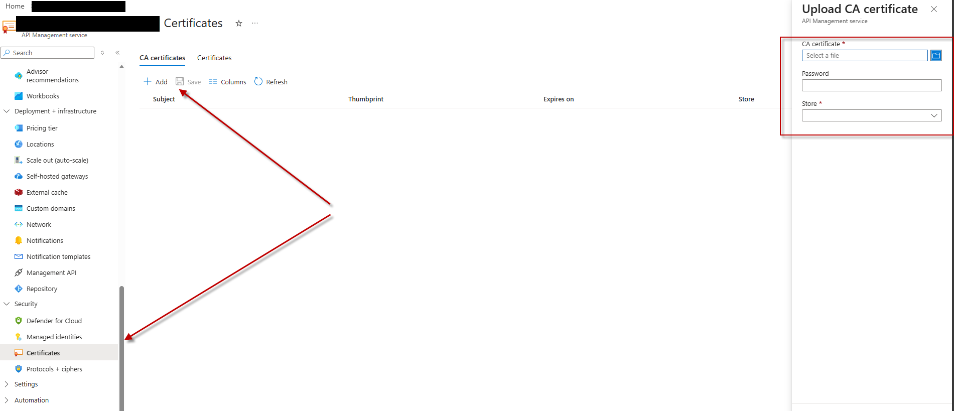

    It seems like you are encountering issues with the connection to your backend service that uses a self-signed certificate signed by a private CA. Here are some steps you can take to troubleshoot and resolve the issue:
    1. Upload the Root CA Certificate: Ensure that the root CA certificate of your private CA is uploaded to your Azure API Management instance. This is necessary for the API Management service to validate the backend service certificate. If you haven't done this yet, follow the guidance on how to add a custom CA certificate in Azure API Management.
    2. Check Certificate Chain: Verify that the entire certificate chain is correctly configured. If your backend service certificate is issued by a private CA, you must upload the corresponding root CA certificate to the API Management instance.

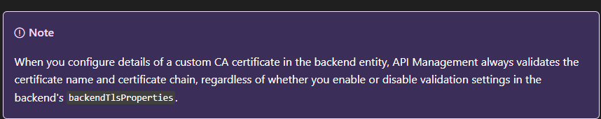

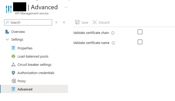

    3. Certificate Validation Settings: Make sure that the certificate validation settings are correctly configured in your API Management backend settings. If you are using a self-signed certificate, ensure that the certificate chain validation is enabled unless you have a specific reason to disable it.
