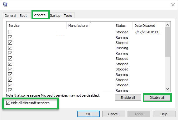

    2. Press Windows logo key + R, type msconfig, and press Enter.
    3. Go to Services > check Hide all Microsoft services > select Disable all.

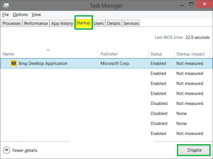

    1. Open Task Manager, go to the Startup tab, and disable all startup items.
    1. Restart your device.

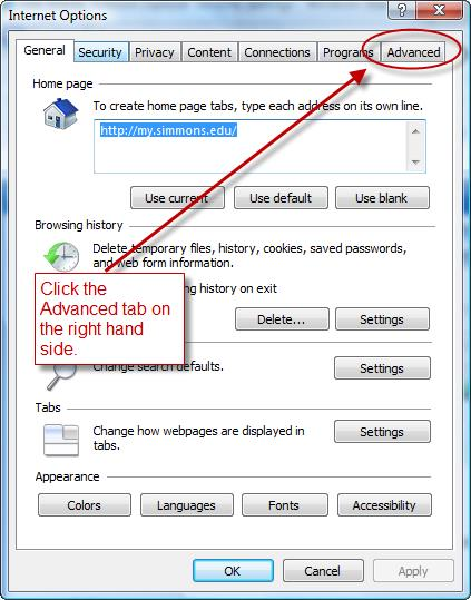

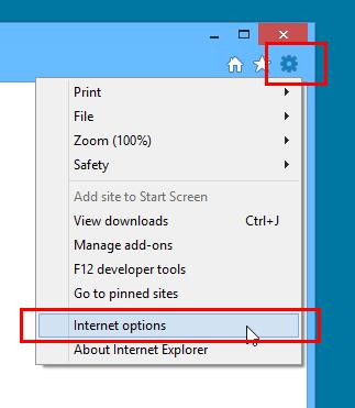

    5. Open Internet Explorer > Settings > Internet Options > Advanced.
    1. Ensure the following are checked:
      • Use SSL 3.0
      • Use TLS 1.0
      • Use TLS 1.1
      • Use TLS 1.2
    2. Restart your device again and check if the issue persists.

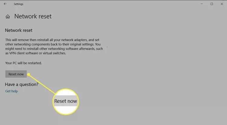

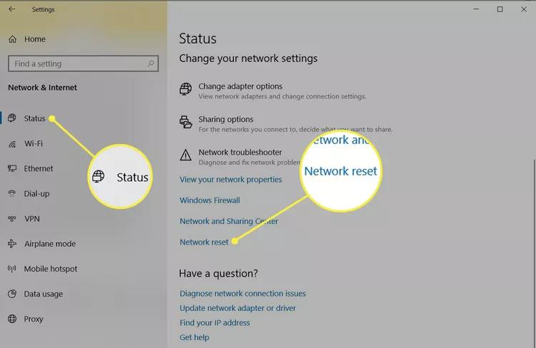

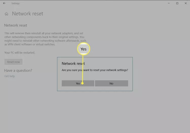

    2/ Network reset
    1. Go to Start > Settings > Network & Internet > Status > Network Reset.
    1. Select Reset now > Yes.
    1. You'll get a warning before the computer reboots, giving you time to save your work and close applications.
