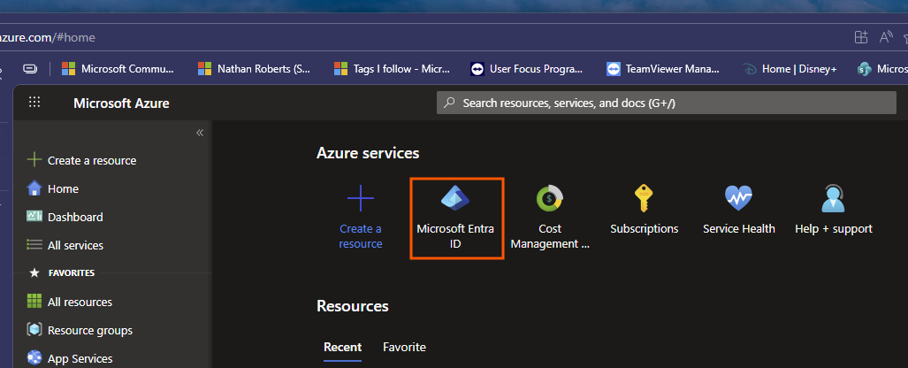

    Please sign into your Azure portal with a global admin account here: https://portal.azure.com
    Once you have signed into your account, please click onto (or search) 'Microsoft Entra ID'

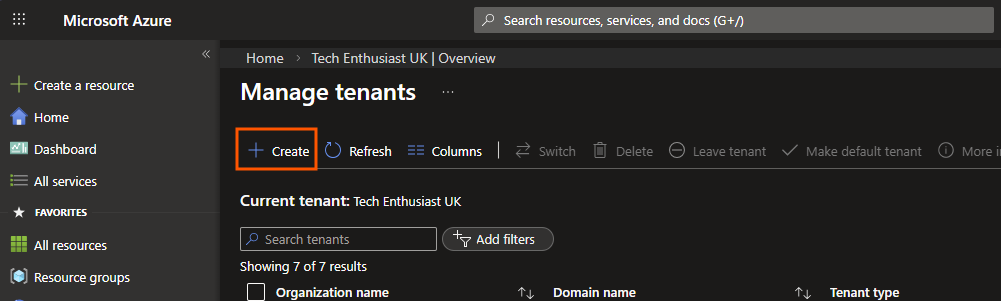

    This will open your overview page for your tenant. You will want to click onto 'Create' on the top navigation.

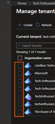

    Then create a new tenant first with the desired name. Once you have set up the tenant using your desired setup and configuration, you can then delete your previous tenant if you want to. You would need to select the tenant you wish to remove using the checkbox on the left-hand side.
    Then click onto 'Delete' from the menu above the table
