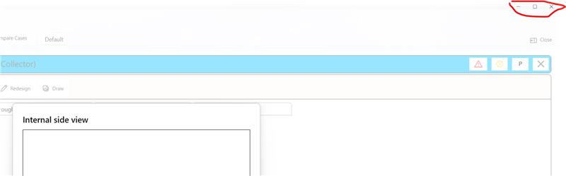

  3. Application close button: We would like to handle the validations before the application closes when user clicks on 'X' button of application. Winui 3.0 doesn't have any event handling mechanism on close button. Can you suggest how to achieve this?

    1. Handling the close button (‘X’):
    WinUI 3 doesn’t provide a direct close event by default, but you can use the window’s Closing event or the AppWindow API to intercept closing. In that event, you can validate data or show a ContentDialog to confirm closing. If needed, cancel the close by setting args.Cancel = true.
