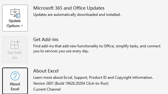

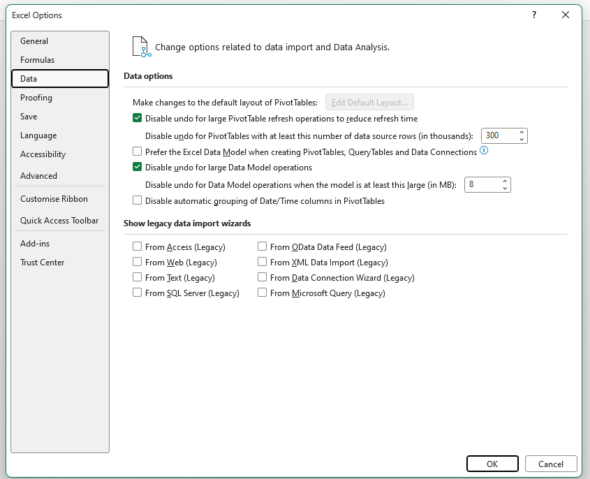

I had the “Automatic Data Conversion” settings before. It allowed you to disable the removal of leading zeros, displaying long numbers as scientific notation, converting letters and numbers to dates, etc. I can no longer find this section. How to get the settings back?
I'm using
But when i go into settings the Automatic Data Conversion is missing?

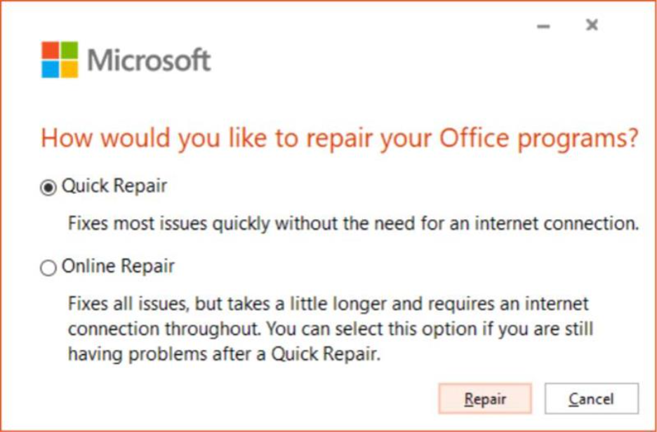

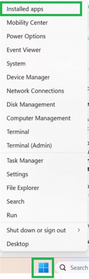

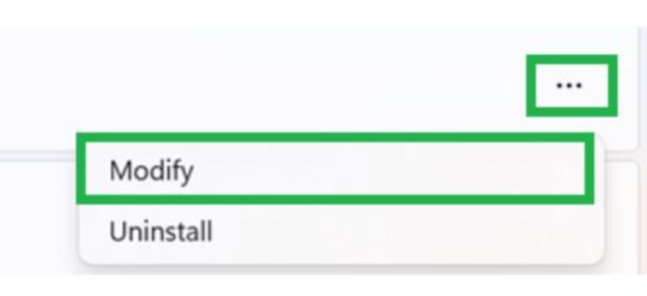

    First, please repair your Office installation. Right‑click the Start button in the lower‑left corner of your screen and choose Installed apps.
    Find your Microsoft 365 or Office product, click the ellipsis (), and select Modify.
    You will see two options:
    • Quick Repair: This runs quickly and fixes most common issues. Try this first.
    • Online Repair: This is a more thorough repair that requires an internet connection. It essentially re-downloads parts of the installation. If Quick Repair doesn't work, use this option.
    Follow the on-screen instructions to complete the repair process. After it's done, restart your computer and try opening Excel again.
    Here is the reference: Repair an Office application - Microsoft Support

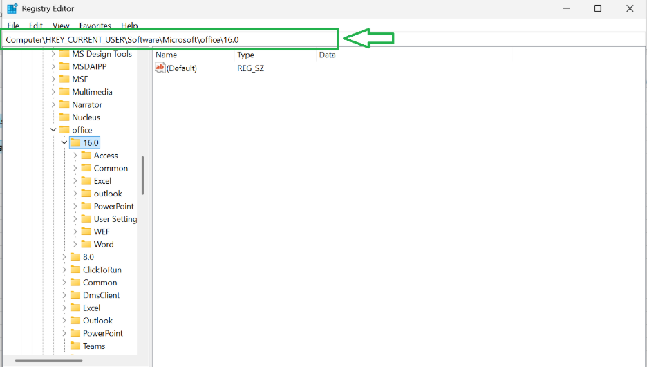

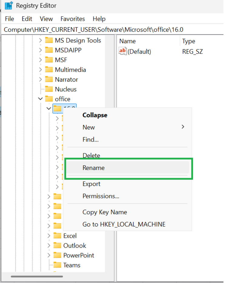

    If the repair process does not restore the missing setting, please try re‑generating the Office registry key. Please note that modifying the registry can affect your system, so it is recommended that you back up the key before making any changes.

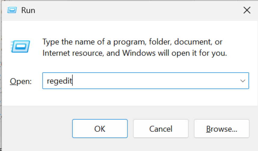

    Press Windows + R to open the Run dialog, type regedit, and select OK to open the Registry Editor.
    Navigate to: HKEY_CURRENT_USER\SOFTWARE\Microsoft\Office\16.0
    Rename the 16.0 folder to 16.0-old, then restart your PC. After the restart, open Excel, sign in with your Microsoft 365 account, and check whether the “Automatic Data Conversion” section has reappeared.
