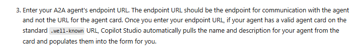

    1. Check API Keys: If you are using Azure API Management, you might need to send a Ocp-Apim-Subscription-Key header instead
    https://learn.microsoft.com/en-us/microsoft-copilot-studio/add-agent-agent-to-agent
    Once you add the right key/token, the JSON error will disappear, and you will receive the full Agent Card with all the JSON-RPC documentation you are looking for.
