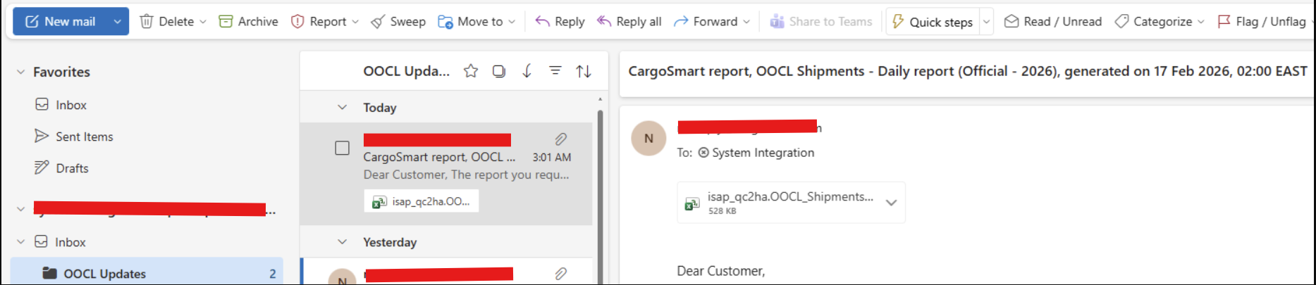

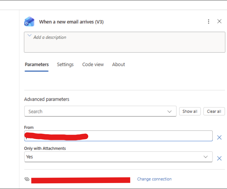

I have setup an Azure Logic App with the trigger of When a new email arrives (V3). However, even though there are emails received, the trigger doesn't work.
The connector is properly connected using the right email address.
How to resolve?

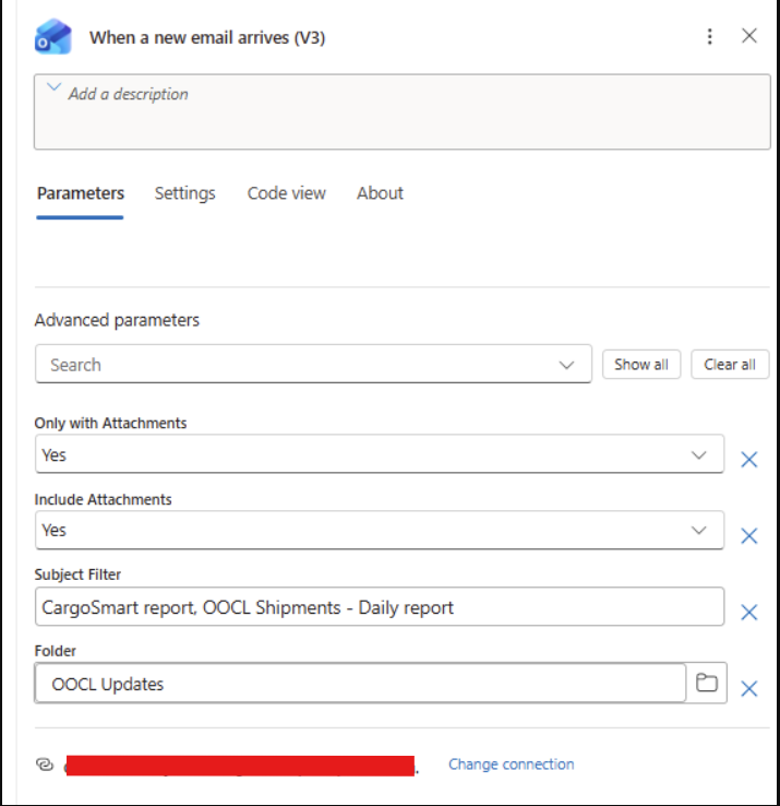

Updated: the problem is gone. The issue is because I had an automatic rule to move the received email into a folder. The flow works seamlessly when I set the folder information in Azure Logic App trigger. Just that.

    I created the Logic App from scratch to figure out the root cause of the issue. I've found out that the flow worked with simple setup, and it only stopped when I set an automatic rule in Outlook to move emails to a specific folder.
    With additional folder settings, the flow is back to work.
