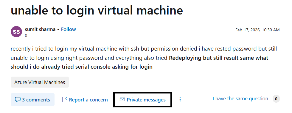

unable to login virtual machine
sumit sharma 0 Reputation points
2026-02-17T05:00:54.2533333+00:00
recently i tried to login my virtual machine with ssh but permission denied i have rested password but still unable to login using right password and everything also tried Redeploying but still result same what should i do already tried serial console asking for login
