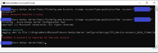

We installing an Azure DevOps on premise.
We are trying to configure the application with a gMSA account.
It doesn't work and we don't understand why?{F2CF4926-15E4-4E74-B921-D27D4A6841AA}

  2. Marcin Policht 81,705 Reputation points MVP Volunteer Moderator
    2026-02-17T12:56:24.1433333+00:00
    From the screenshot the error indicates that the -pswd option requires a value and then Azure DevOps reports that a password is required for the user account. When you use a gMSA, there is no password you manually provide, but TfsConfig.exe still requires the parameter to be present. If you omit it entirely, the tool throws that error.
    For a gMSA account you should include the password parameter and pass an empty string. The account name must also end with $.
    The command should look like this:
    TfsConfig.exe Accounts /change /AccountType:ApplicationTier /Account:DOMAIN\gmsa_account$ /Password:""
    If it still fails after that, verify the gMSA itself is correctly configured on the server. On the Azure DevOps server, run:
    Install-ADServiceAccount gmsa_account
    Test-ADServiceAccount must return True. If it returns False, the machine is not authorized to use the gMSA or the KDS root key has not been properly created in Active Directory.
    Also confirm that:
    setspn -L DOMAIN\gmsa_account$
    returns valid SPNs and that the computer object of the Azure DevOps server is listed in the gMSA’s PrincipalsAllowedToRetrieveManagedPassword.
