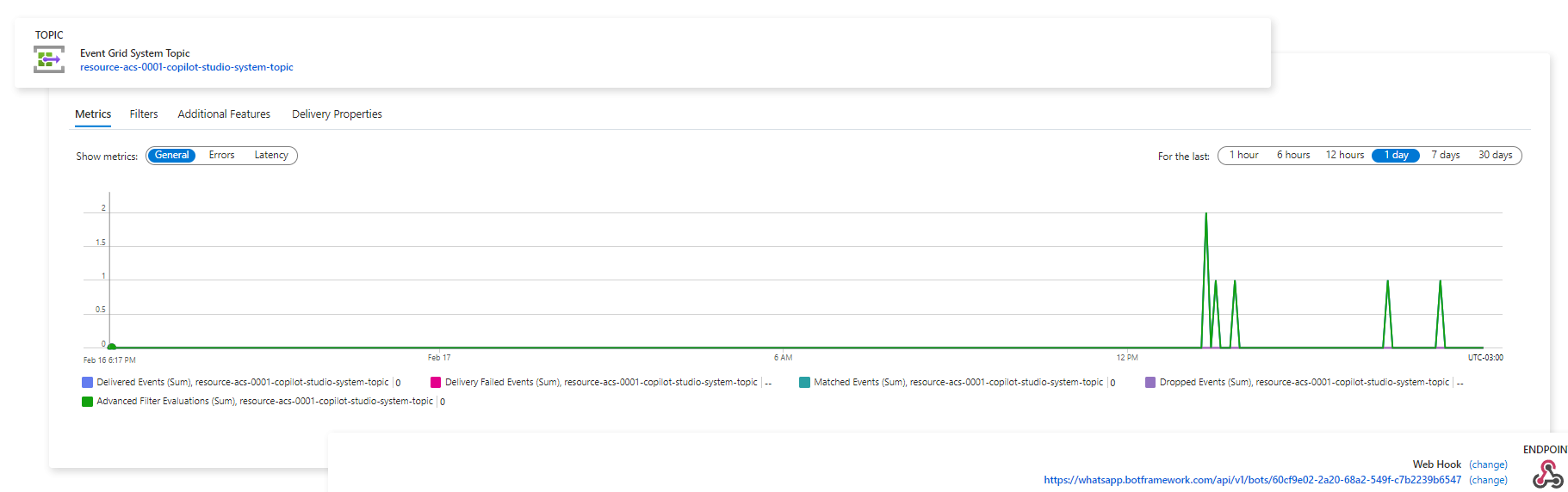

I connected WABA to ACS , is working , i can send message using the ACS with Javascript to my number. So basically WABA is OK , ACS is OK.

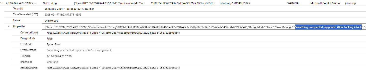

When i connect it to copilot studio ( i did like 15 times , recreated Agent , Recreated ACS , i try to unbind and bind it again a lot of times) i always get the same error.
"**Something unexpected happened. We're looking into it."
Cant find how to fix it , anyone can help me ?

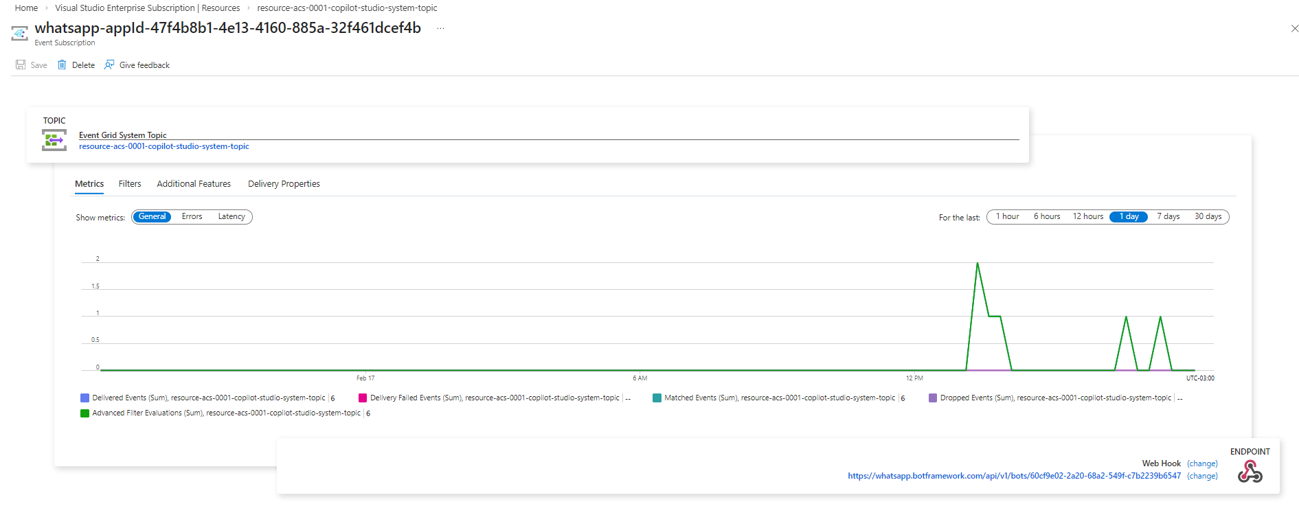

    can you explain that ? I have the eventsubscription On and running , where should i go to update the endpoint that is not at the docs.

    EventSubscription is On.
    Yes i did all the steps from tutorial and videos from Microsoft.
    Event subscription is running.
