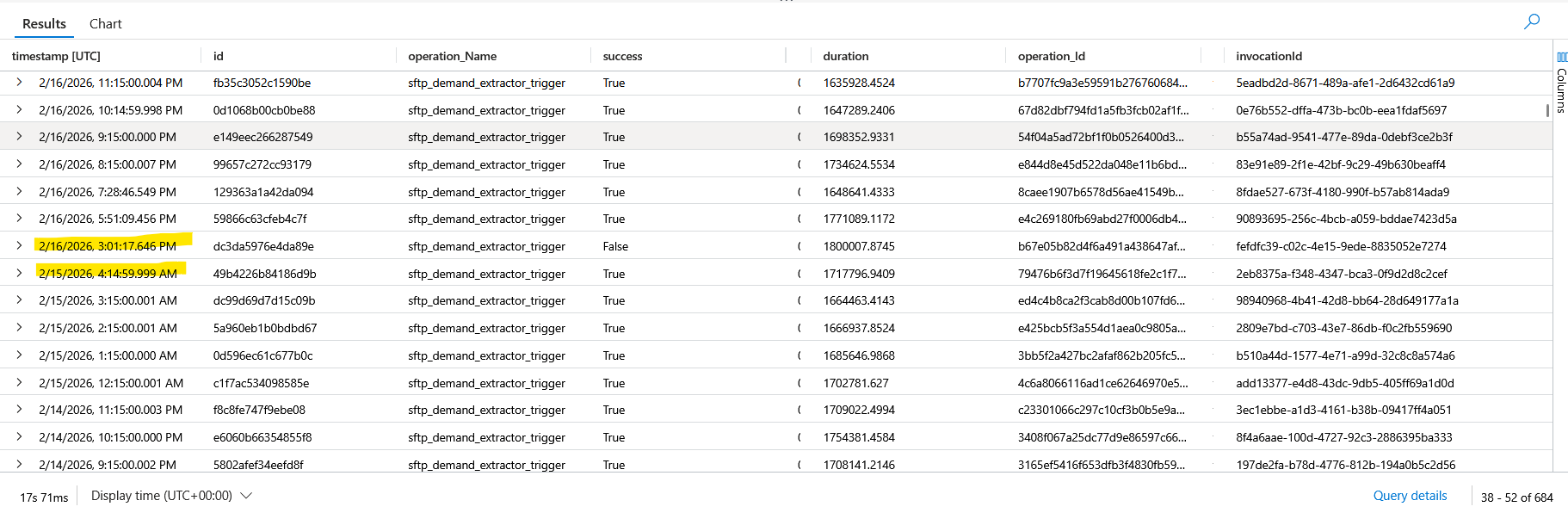

  • Last successful invocation: 15/02/2026 at 04:15 UTC
  • After that, no invocations appeared in the Invocation tab
  • No logs were generated in Application Insights
  • It did not trigger again for almost 24 hours
  • Restarting the Function App manually caused it to resume normal hourly execution
Attached is a screenshot of the Invocations showing that the function stopped running for approximately 24 hours.

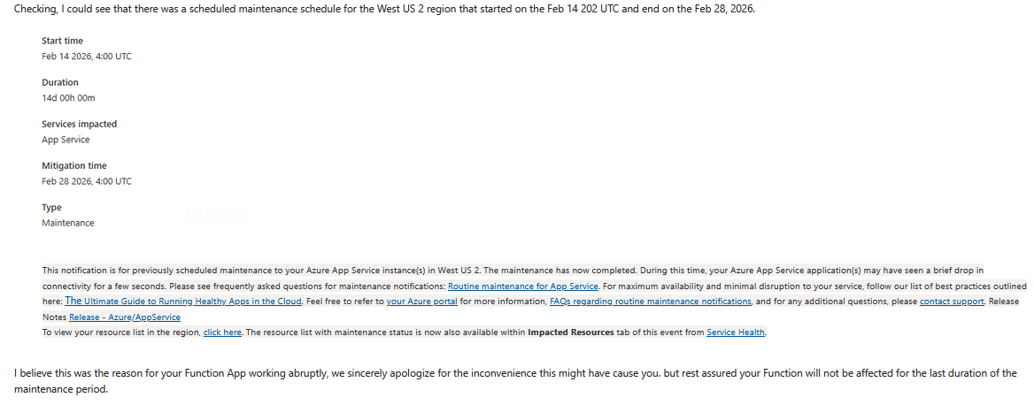

    Your CRON expression is correct and runs hourly at minute 15 UTC. Since there were no invocations or logs for nearly 24 hours and execution resumed immediately after a manual restart, this indicates the Functions host stopped processing the timer rather than an issue with your code or schedule.
    On the Flex Consumption plan, timer triggers rely on a running host instance and storage-backed schedule monitoring (AzureWebJobsStorage). If the app scales to zero, the host becomes unresponsive, or there is a storage connectivity/lease issue, the timer may not fire until the app is restarted. Restarting forces the host to reinitialize and reacquire the timer lease, which explains the recovery.
    This is most likely a host lifecycle or scale-related issue, not a CRON misconfiguration.

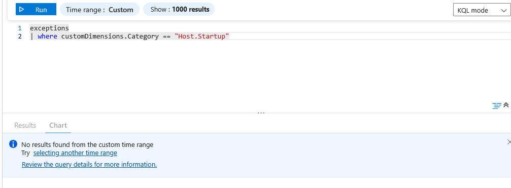

    1. Function Runtime Not Starting: There may have been an exception that caused the function runtime host to fail to start. You can check Application Insights for any errors during startup:
       exceptions
    | where customDimensions.Category == "Host.Startup"
    1. Invocations Timing Out: If your function had ongoing executions that got stuck, it might prevent new invocations from occurring. Check if you have a timeout set in your host.json configuration.

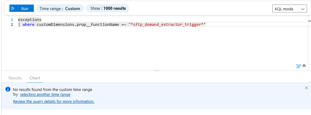

    2. Application Insights Logs: Since you mentioned that no logs were generated in Application Insights, ensure that logging is properly set up. You may run a query like this for any invocation failures:
       exceptions
    | where customDimensions.prop__functionName =~ "*YourFunctionName*"
