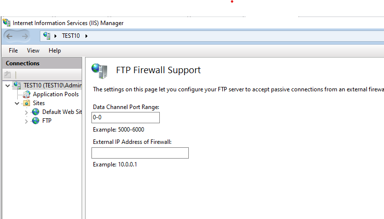

Yet using filezilla as test, logs in successfully but fails on retrieving directory with "connection timeout" I confirmed its connecting using passive mode (pic attached)
Need help in getting this service working for us.

    • Configure a fixed passive port range 49152-65535 in IIS.
    • Open only that defined port range in IIS
    • Allow the Port 21 and 49152-65535 in Azure Network Security Group.
    • Windows Firewall
    Once the passive port range is consistently configured and permitted across all layers, FTP directory listing should work as expected.
