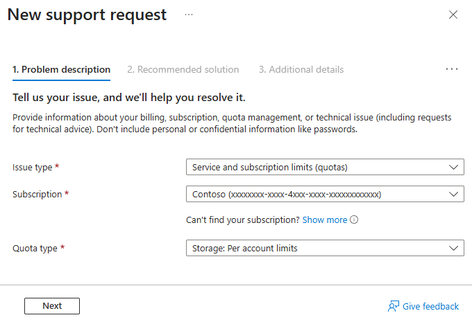

    Please carefully follow my instructions below to create a new Service and subscription limits (quotas) request quota increase to increase Ingress limit on your storage account.
    1. Navigate to this link to start the process:
    https://portal.azure.com/#create/Microsoft.Support
    2. Enter quota in the box and click Go
    3. Select Service and Subscription Limits (Quotas) / Service and subscription limits (quotas) and click Next
    enter image description here
    4. Click Create a support request button, as shown
    5. Select Issue type: Service and subscription limits (quotas), Subscription, Quota type: Storage: Per account limits, click Next

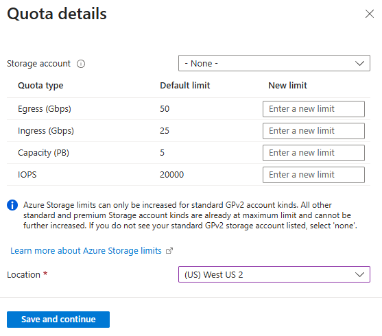

    6. Now you should be on Additional details tab. Click Enter details
    7. Select Storage account, enter new limits for each quota type, select Location, and then click Save and continue
    8. Finish filling out Additional details tab, click Next, review and click Create. You should receive an automated email within a few minutes.

    To increase the ingress limit on Azure Blob Storage, you need to request a higher capacity limit. You can do this by contacting Azure Support. Here are the steps to request an increase:
    1. Sign in to the Azure portal.
    2. Navigate to Support + Troubleshooting in the menu bar.
    3. Select Create a support request.
    4. Choose Service and subscription limits (quotas) as the issue type.
    5. Specify the quota type you want to increase, which in this case would be related to Azure Blob Storage.
    6. Provide any additional information required for your request.
    Once your request is submitted, Azure Support will review it and inform you about the possible increase in your ingress limit.
